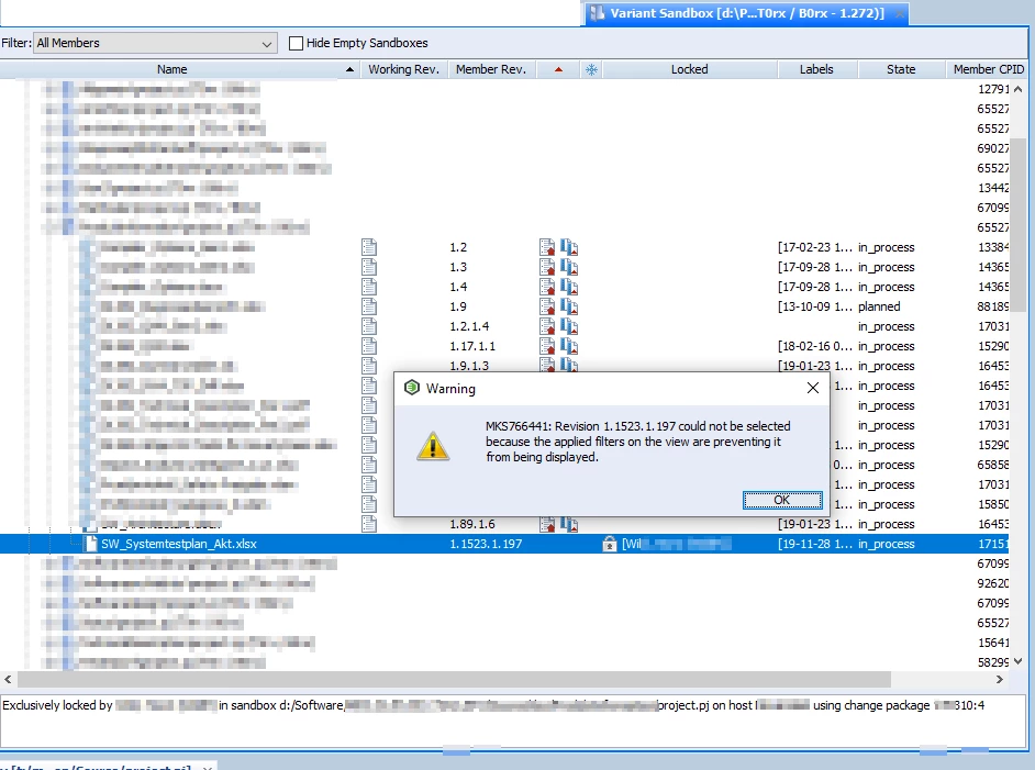

MKS766441 - Revision could not be selected because the applied filters on the view are preventing it
We are using Integrity Client 11.0.0.506
Because of some applied filter I can't see the file Member history. The following error occurs:
MKS766441 - Revision ... could not be selected because the applied filters on the view are preventing it from being displayed
I attached a screenshot with the problem. Thank you !

By default the number of displayed revisions  in the Member History is set to 200
To change this parameter:
- Select the Member History view
- Go to the View menu, then select ---> Maximum trunk revisions  menu option--> All
