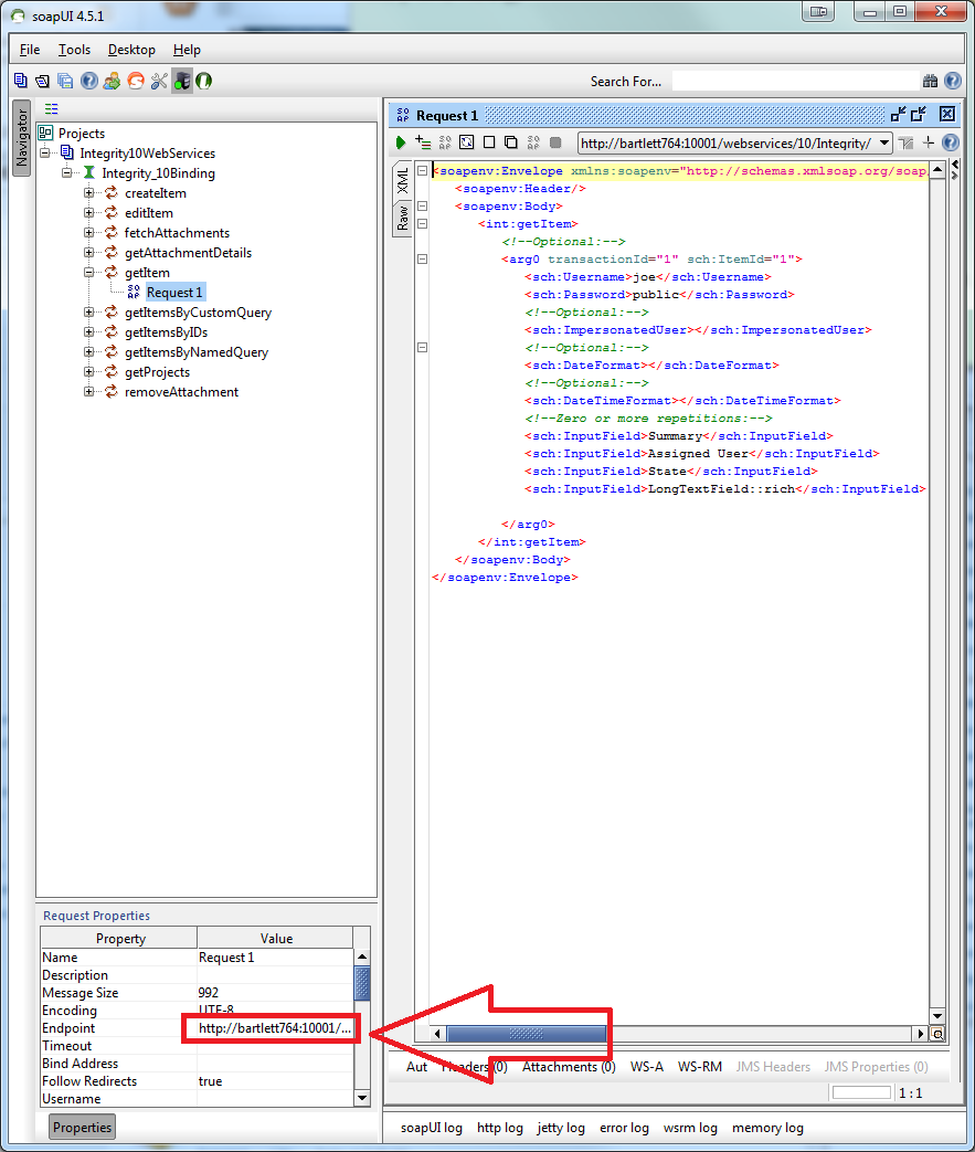

    Hello Hendrik, what is the endpoint WSDL URL you are using with SoapUI? The "mks1" hostname and port 9001 are just examples given for web services and you must use your own Integrity Server. In SoapUI you can check this info in the Request Properties section as in the below screenshot:
    Apr 5, 2014 9:27 AM UTC
    Server name and port are different, I altered it to post it here. There is no problem with them, since my colleagues get valid answers. I checked the http answers even with Wireshark. The server responds, but just says I'm not authorized
    Thanks for your answer
    Apr 7, 2014 2:24 PM UTC
    Ah then it is very likely login permissions on the Integrity Server itself. Check with your Integrity administrator to make sure you have the appropriate access and if that all seems good, open a case with PTC Integrity Support to take a closer look at the configuration.
