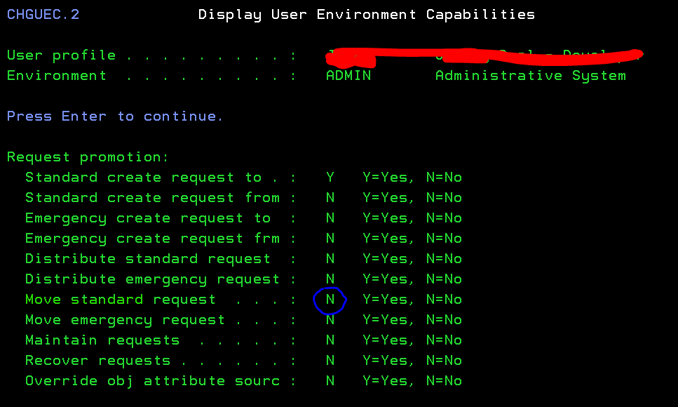

    Absolutely we have our system setup on their user profile in Implementer to not allow promotion
    with in the user profile  option 41
    select the developer with option 15 Environment capabilities
    Select the environment in question option 2 to change
    Review settings but specifically the second page as shown above.

    Well, yes, that would restrict someone from EVER promoting to that environment.
    But we have a small shop, and the point is that both senior people need to be ABLE to promote to production, but we would like to prevent them from promoting items that they checked out.  In other words, if Developer A checked out an object, then Developer B must promote it to production, and vice versa.  But both Developers must be able to promote to production.
    This would insure that two sets of eyes had looked at the changes.
    On many projects this would mean that promotions to production would be doubled: if both senior developers worked on a project, then each would have to promote what the other developer worked on.  That is an acceptable trade-off for the benefit.
