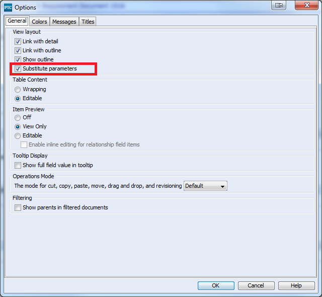

    Hi Nolin, do you have Parameter Substitution enabled in that particular context? You should click on the document/item/whatever you are looking at and then go to the View -> Options menu:
    Depending on the context you are in, the parameters may appear right away or you may need to refresh (F5).

    I do have substitute parameters enabled. It works fine if I just type the parameter name into a text field. When I use it as part of a concatenated value in a calculated field though it doesn't work. I've tried refreshing as well as closing and reopening the document.
