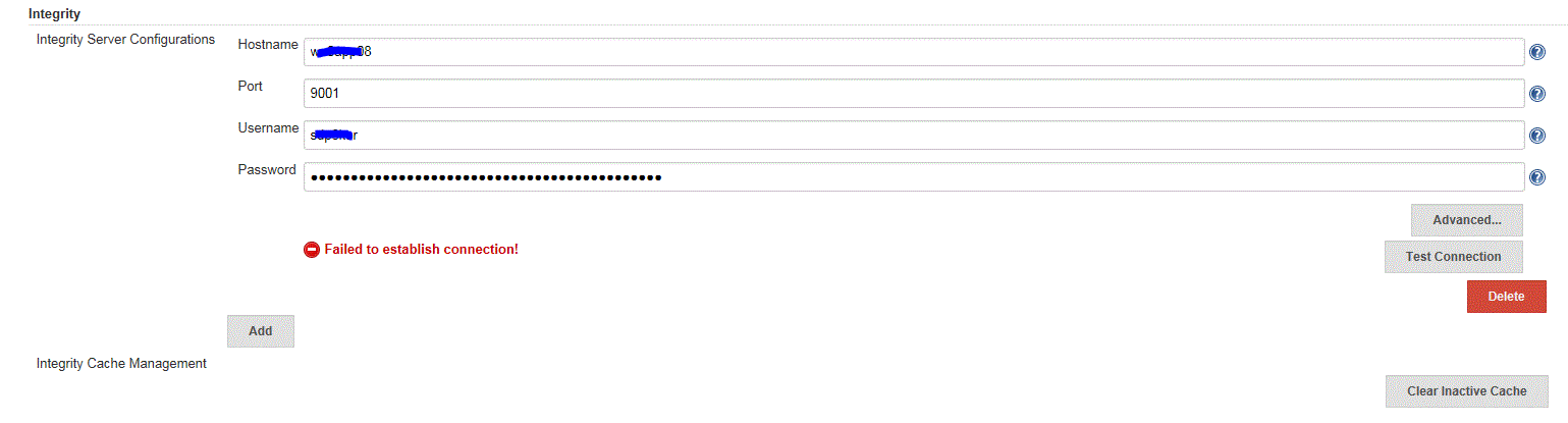

The issue is regarding the configuration of PTC With Jenkins
The tools used are
1) MKS Integrity Client 2009
Build: 4.10.0.9665
Service Pack: 007-01
2) Jenkins version 1.599
3) PTC Integrity CM - Jenkins Plugin : 1.31
The link "https://wiki.jenkins-ci.org/display/JENKINS/PTC+Integrity+Plugin" depicts the configuration process. The integrity hpi file is uploaded
manually. Upon success, proceeding with the configuration there is an error that occurs while testing the connection. The entries include
hostname
port
username
password
Error: Failed to establish connection!

pmerkleAnswer
when creating a PTC Session via the Integrity Java API an APIException can be thrown for serveral reasons:
1. Wrong hostname or port
2. Incompatible API version
3. Wrong user name or password
For further investigation it would be helpful if you add the complete server.log file as attachment to your question.
Peter
6 replies
Have you tried connecting to the server from the same host that the Jenkins integration is installed on using the GUI or web UI with the same credentials? If it does work, I would investigate the API configuration of the Integrity server. If it doesn't work, I would suggest:
  • Making sure the credentials are valid
  • Making sure that workstation can connect to that server on that port (general network connectivity, firewall rules)
I hope that helps.
Kael
I don't think that the newest version (1.31) of the PTC Adaptor for Jenkins works with MKS Integrity Client 2009.
The lowest Integrity version the plugin supports is Integrity 10.3.

I have found the following statement on the web page
https://wiki.jenkins-ci.org/display/JENKINS/PTC+Integrity+Plugin#PTCIntegrityPlugin-PluginforUnsupportedConfigurations
under the section “Plugin Unsupported Configurations”:
“With the release of integrity-plugin 1.29, versions older than Integrity 10.5 are no longer supported. A special one off version 1.31-4.10.9049 has been created for users who want to take advantage of the recent fixes but need more time to migrate from Integrity 2009 SP6, SP7, 10, 10.1, 10.2, 10.3 and 10.4. There will be no more fixes provided for configurations older than Integrity 10.5.”
I hope that will help you …
