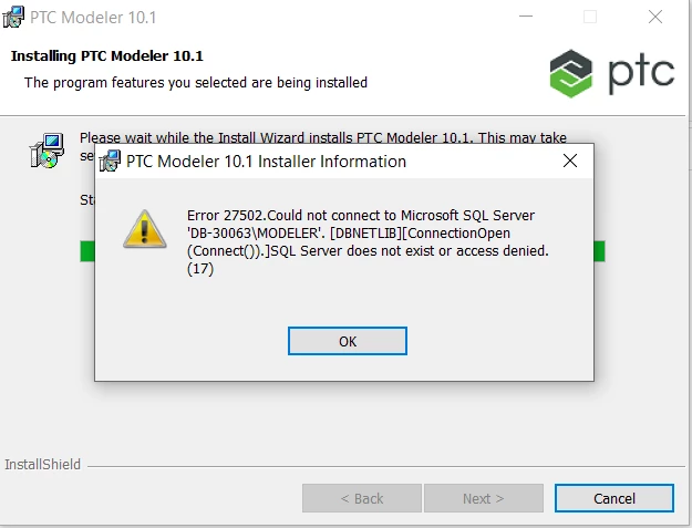

Hello. I'm trying to install PTC Modeler 10.1 to my computer, with Standalone configuration, however could not manage it. Before I start, I want to inform that,
- I have 2 user account (Administrator and Local User) .
- I run installation module as Administrator,
- I disable my Antivirus software,
- I'm working in an offline environment, with my network card is enabled.
  1.  As far as I know from the installation guide, the installation module contains SQL Server Express 2019, so if I check "Local Modeler Server Instance" on installation configuration page, it will install and configure MODELER SQL instance by itself. Since I don't have SQL Server installation in my computer, I took that route. When it comes to the installation of SQL instance, it gives the error seen in "Capture_Installation_SQLServer.PNG" and rollbacks the installation.

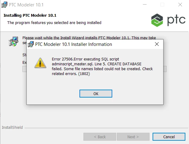

  2. I installed SQL Server Express 2019 with all features, and SQL Server Management Studio 2019 to my computer, created default SQLEXPRESS instance and gave Read/Write permission to both Administrator and Local user account. In Modeler Standalone installation, I disabled "Local Modeler Server Instance" configuration. This time, it gave the error seen in "Capture_Installation_ExternalServer_SQLScriptError.PNG" and rollbacks the installation.

Hello VladimirN,
I looked the articles but those error types are not the same as I encountered (Those are related to SSL Handshake, in my case, SQL Instance seems not exist), nevertheless, I tried the suggestions as:
- I'm performing the installation with no connection to any network, with Administrator rights, to eliminate any policy rule restriction, but no effect.
- I controlled the registry values for TLS protocol (TLS 1.2) and ensured it is enabled for both Server and Client keys, however it does no effect.
