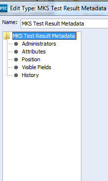

One area that we are unsure of is the "MKS Test Results Metadata" item in the vanilla ALM Integrity build. When viewed from the Integrity Administration Client under Workflows and Documents > Types > MKS Test Result Metadata, the item has abbreviated item details compared to other item types:
This makes me suspicious that I cannot build it by hand by going to Workflows and Documents > Types, selecting "Create New", and copying all the build details from the vanilla ALM Build. Does anyone know if it is possible to recreate the MKS Test Results Metadata item type from the Integrity Admin Client? Are there going to be any other issues with this approach (MKS Solution item, Schedule item, etc). If this is not possible, is there another way?

Regarding MKS Test Result Metadata:
  • It's not a "normal" Integrity item type
  • There is no way to create one from the Admin GUI
  • It has to be created from the CLI with this command:  im createtype --testresult --name=TestResultMetadata (the value of --name can be changed)
  • You can only create one such item
I hope that helps.

Our idea is to avoid the data model and structure collisions of a merger process by instead building the item types manually in one of the instances. In this way, it would be similar to building new item types in a single instance instead of merging integrity instances. Currently, we are only concerned with bringing over the item types, triggers, configurations, etc., into a merged environment. It is understood that we will need to address some configuration overlaps and misalignments in the process of rebuilding manually. However, we are having trouble rebuilding the "MKS Test Result Metadata" item found in the vanilla ALM Integrity solution because it does not seem to be a regular item type in the Integrity system.
In reference to the original question, is it possible to build the "MKS Test Result Metadata" item type manually through the Integrity Administration Client?
I hope that helps.
