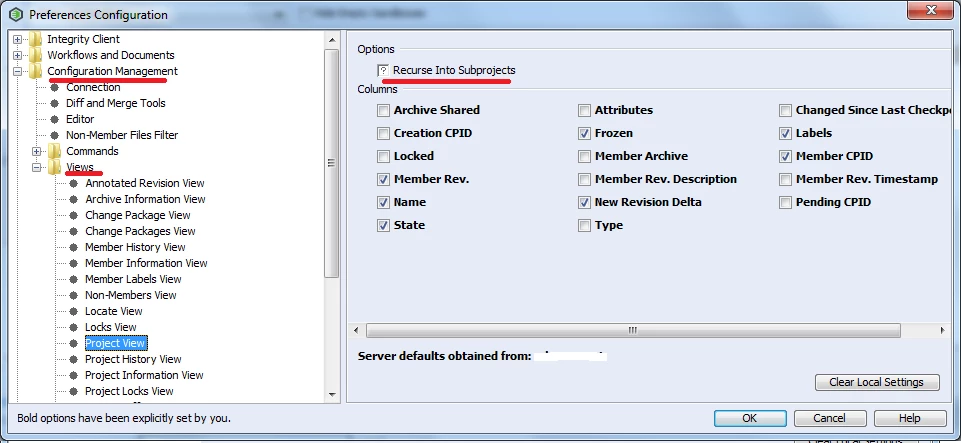

[?] Recurse Into Subprojects checkbox in Project View and Sandbox view Preferences
We are using PTC Integrity 11.0.0.506, API Version  4.16.506
1) In Preferences -> Configuration Management -> Views -> Project View
there is a checkbox
In the documentation is written
Project View  - Recurse Into Subprojects - displays the hierarchy of subprojects.
But in my opinion, the Integrity Client behaves in the same way, regardless the checkbox is on/off/?

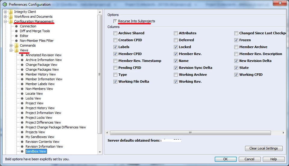

2) Similarly
In Preferences -> Configuration Management -> Views -> Sandbox View
there is a checkbox
Sandbox View  - Recurse Into Subprojects - displays the hierarchy of subprojects.
But again in my opinion, the Integrity Client behaves in the same way, regardless the checkbox is on/off/?

Sep 18, 2018 2:31 PM UTC
It does appear to do nothing. I thought it might set the preference for the CLI, but it only sets it for GUI, and the option doesn't matter in the GUI.
I'm pretty sure at one point in the past (very distant past) it did something, and no one thought to remove it.
The option should be removed.
