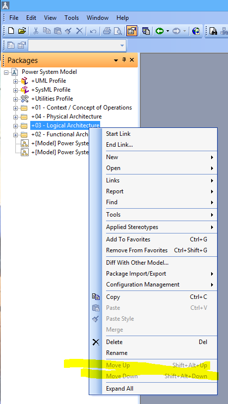

Reordering Packages?
How may I reorder packages in the Package Browser?  I'm able to do it easily with its contents (Shift+Alt+up/down), but the option is grayed-out at the Packages level:
(I'd like to put them in 01, 02, 03, 04 order)

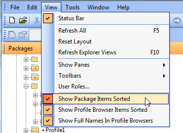

    PatrickOllerton
    Feb 23, 2017 3:19 PM UTC
    hi Chris,
    There is an option under the View menu to sort packages:
    Hopefully this provides what you need.
    regards,
    Patrick
    cfreund1-VisitorAuthor
    Feb 23, 2017 3:40 PM UTC
    Patrick,
    I toggled between all those options, and they had no effect.  What is the sorting criteria? Date of creation?  Whatever it is, it's neither alphabetical nor numerical.
    I'm using 8.3.18 by the way.  Patches 8.3a and 8.3b are also installed.
    PatrickOllerton
    Feb 23, 2017 5:06 PM UTC
    hi Chris,
    You only need to toggle the "Show Package Items Sorted" option.
    That's strange, it works for me - see images below. If sorting doesn't work for you, I suggest you create a Support call so they can help resolve the problem.
    Here are my packages with the "Show Package Items Sorted" option de-selected:
    Here they are with the option selected:
    There is also a way to explicitly define the order of items - I'll add that in another reply.
    regards,
    Patrick
    Update: Support tell me that sorting does not work as expected at the root of the model - hence the problem you are seeing. We already have this issue captured in our database.
