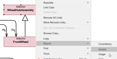

hello,
Can you give a concrete example? - which diagram and element type are you using?

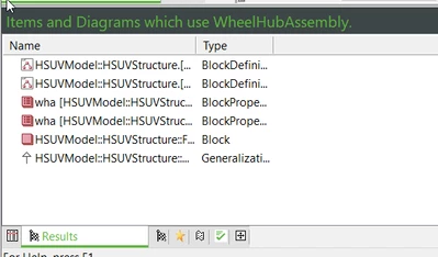

I'm using Modeler 10 and I can see the command - see below - and it works as expected by outputting the information to the Results pane.
