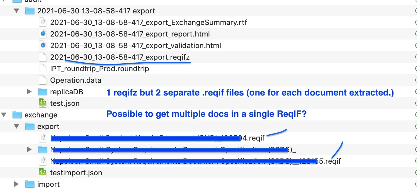

I'm exporting 2 documents (e.g. System requirement and Software Requirement) from PTC Integrity using the Requirements Connector, I see it creates 2 ReqIF files (one for each document).
Most tools I've worked with generate just 1 ReqIF file such that each document is considered a unique "spec" in the single ReqIF. Is it possible to just have 1 file for multiple documents so I can put an entire project in a single ReqIF? This will allow creation of trace relationship links between the documents with importing in target tool.
let me know if I am missing how to do this.
