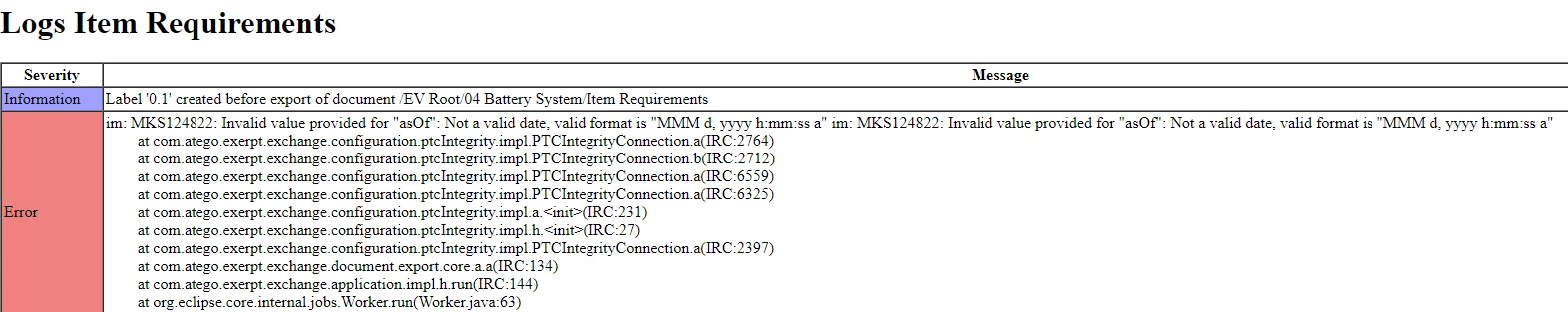

Requirements Connector Export Error
I am using Requirements connector 4.2 version and PTC RV&S 13.2.
I have created a mapping file and by default i have left the server date format blank.
When i try to export an reqIF file, i get the following error:
MKS124822: Invalid value provided for "asOf": Not a valid date, valid format is "MMM d, yyyy h:mm:ss a"
I did try to set the date and time format as per Canadian standard, as the servers are in canada but i was not successful.
Looking forward to your support.
