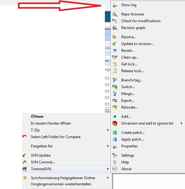

In TortoiseSVN i can simply see in the WindowsExplorer in which Folder is a Change in a file.Tortoisesvnstate1.jpg
I can right click the Folder in the Explorer and will get instantly the Option to see all differences in the Folder lokally compared to the repository .

Then i can also right click in the Explorer on a Folder and see the Log.

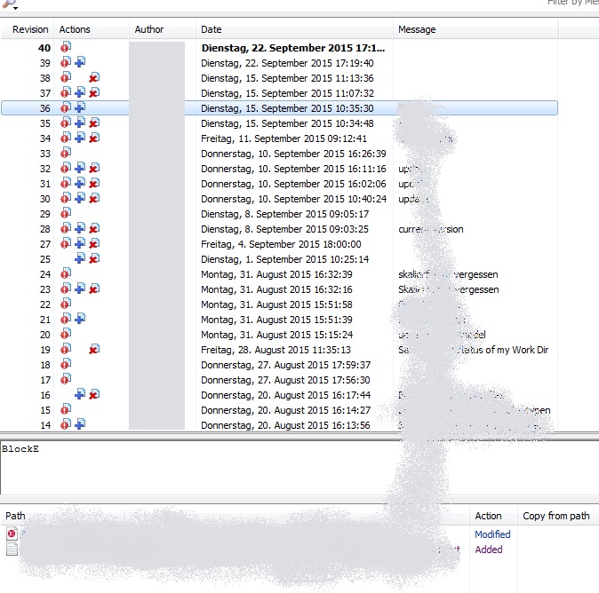

But what i really really missing is a overview about the whole Project-Source-Code-History.TortoisesvnHistory.1.jpg
In Tortoise you just right-click the Folder and then press the Button "Log" and will see the whole SourceCodeHistory.
In PTC i can only see a Single-File-History or a Project-History.

    So, my Problem is, that the Checkpoints are to old for me. i am basicly somewhere between the last checkpoint and the current developement Status.
    And because there is no Checkpoint of the very last day of development, there is nothing to compare too ... or is there?
