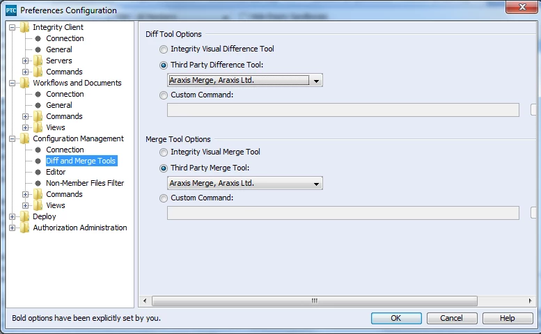

I am using Integrity 10.8.0.8356.
Under File->Preferences->Configuration Management -> Diff and Merge Tools
the user can set the  preferred Diff command and Merge command.

Unfortunately, there is no way to set the Diff or Merge command from the CLI.  One can only set this in the GUI preferences or by directly editing the IntegrityClientSite.rc file.
