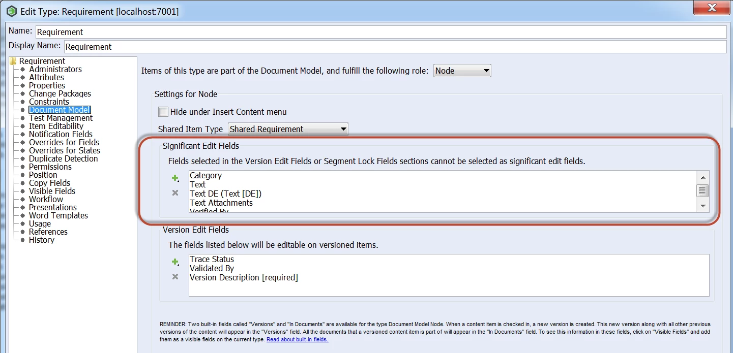

Problem Statement: Significant Edit date or Input revision date of a Node is modified when that node is moved within the document at Integrity 11.1.
Is there a way to control the standard fields like 'contains' to be non-significant change.

Hi Neeraj,
did you check this setting (see attached screenshot)?
Apr 5, 2018 6:44 AM UTC
Hi Volker,
Yes, I indeed checked this.
Contains field is not a part of Significant edit fields in all 3 document model.
