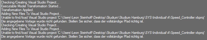

I am new to Integrity and SySim and trying to run the SySim model "Speed_Controller" from the Integrity Examples file.
Whenever I click "Make Model Executable And Run", I get the error message "Unable to find/load Visual Studio project". I attached a screenshot of the preparation tasks window.
Strangely, after the error message occurs, there is indeed a Speed_Controller.vbproj file in the correct directory and it even has code in it.

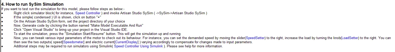

I followed all the steps in the ReadMe file in "Speed Controller" (see attached image) though I don't have the option '->SySim->Artisan Studio SySim' but only '->SySim->PTC Integrity Modeler SySim'.
Manually creating a .vbproj file doesn't change anything.
