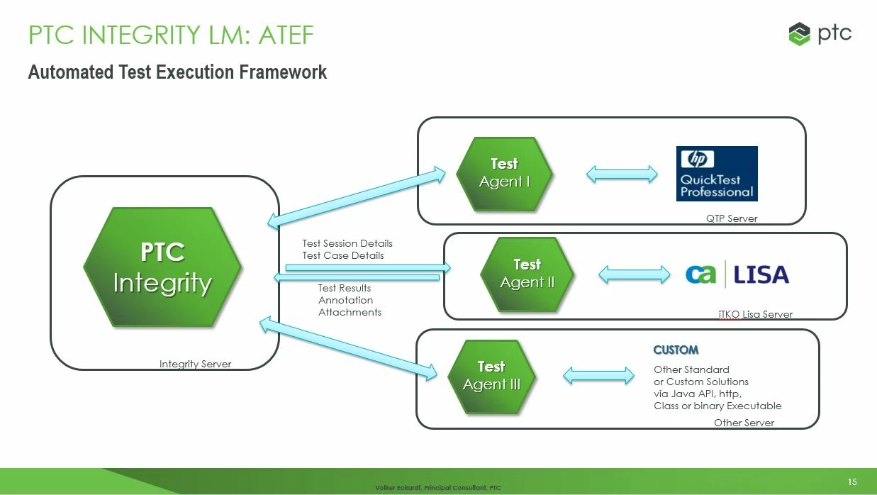

Hallo Harald,
I am attaching for you an ATEF doc that I created some time ago. This should help you to understand ATEF and the way how to implement any new Test connector.
In regards to your questions I can say the following:
ATEF is intended to run on multipe Test Systems in parallel. ATEF consists of so called Agents (mini Servers), which listen to Test Sessions that are dedicated to them. Once an Agend receives a "to be executed Test Session" it reads the Test Session content, executes the cases (and steps) in it and send - after finishing - the results (and logfiles) back to the Integrity Test Session for tracking.
If you are looking for a fully automated test execution process, then ATEF is the right choice.
Volker
