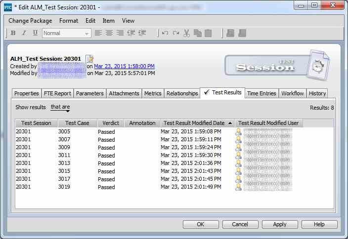

Test Result Modified Date
How do I access the "Test Result Modified Date" value from a trigger? The value I'm referring to is in the below image.

Mar 31, 2015 7:04 PM UTC
I still haven't been able to figure this out. Is this possible?

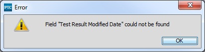

Apr 1, 2015 4:56 PM UTC
I get Not Found when I try to use Test Result Modified Date. The trigger runs when the Test Session is moved to the ALM_Completed state.
var delta = bsf.lookupBean("imIssueDeltaBean");
var resBean = delta.getAssociatedSessionTestResultBeans();
resBean[i].getFieldValue("Test Result Modified Date"); // This is used in a loop in the trigger
I just tried using delta.getRelatedTestResultBeans() as well but it gives the same result of Not Found.

Here is how I get around it...by using the API.  I'd rather not have to go to the API to get something that should be available in the BSF, but you have to do what you have to do.
