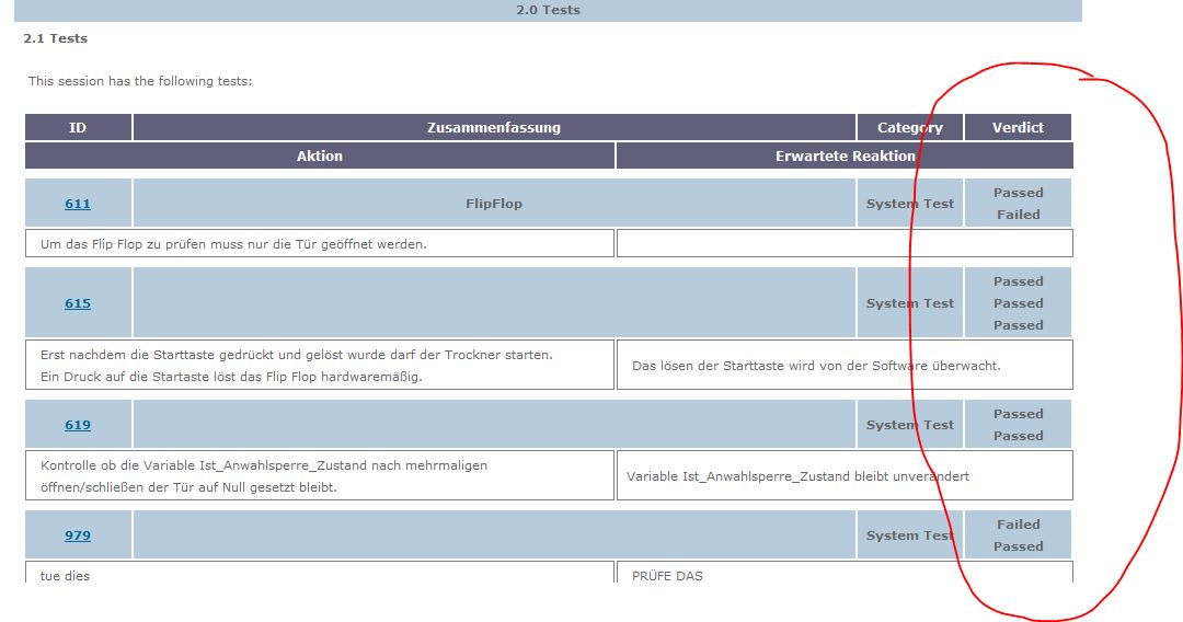

Hi all,
I'd like to create a "Test Session Details" report that covers the follow content.
1. the sessions meta data (run-date, assigned user, test environment , etc.)
2. the used test case data (Text, Passed/Failed criteria, Category, etc. )
and
2.1 the concrete result (verdict) for this test case in this session
#1 and #2 are no problem, but I'm stuck with #2.1.
I cannot find a way to filter the results (related to the test case) for the one result (related to this test session)
The report run with a single Item selection (namely the Test Session's ID) and looks like this

which gives somehting like this
Any Ideas?

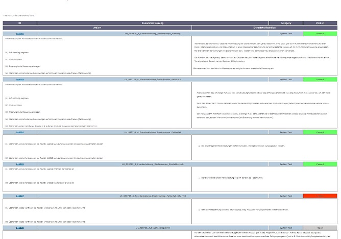

mrumpAnswer
Jun 12, 2013 1:50 PM UTC
Finally, I found a way to solve this:

the Report now look like this:
Just what I wanted:
The complete testsession content with only the concrete results from this testsession.
