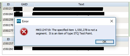

I tried it on the 10.9 client and I'm seeing the same issue so I'm hoping this is a configuration thing that can be fixed. The below error was received when selecting an item in the top relationship field and attempting to trace it to the item on the bottom using alt+drag&drop.

I can reproduce on 12.1 (R&V Solution) and 11.2 (ALM Solution) only if I have the trace field in my document view columns, and use alt-drag-drop from the trace field table to another node in the same document.
It seems to be specific to dragging the item from the relationship field in the document columns.  If I try from the item preview, it's fine. Also from the Relationships viewer, it's fine.
