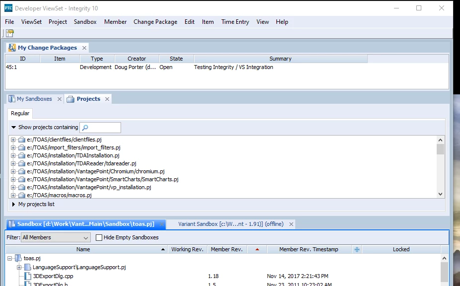

When I view Projects in the integrity client, there's a nice type to filter box ("Show projects containing").
I've always wanted that same functionality when viewing a sandbox, but have never figured out how to do it.  We just upgraded from Integrity 2009 to 10.9 and I was hoping to see it, but I don't.
Basically I'd like a, "Show members containing", box next to the, "hide empty sandboxes", checkbox.
Is it possible?
(I attached a screenshot of what I'm talking about, thinking it would show in my post...  it doesn't...  but you get this nice addendum telling you about it)
awalshAnswer
It's possible to filter on member names, but not on member contents.
To view all members that contain certain text in the name, select Members with Name from the Filter list, and use * for a wildcard: *text*

hyzerfool1-VisitorAuthor
Thanks for the suggestion.  It does work.  Shame it's such a pain to get to.  That is, the real value for me is when I can have a hotkey and start typing and have it filter, ideally as I type.
Oh well.  It's mainly frustrating since that functionality exists in the project view (though if there's a way to assign a hotkey to take the focus to the, "show projects containing", window I'm unaware of it)./
