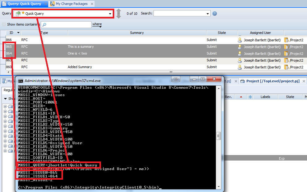

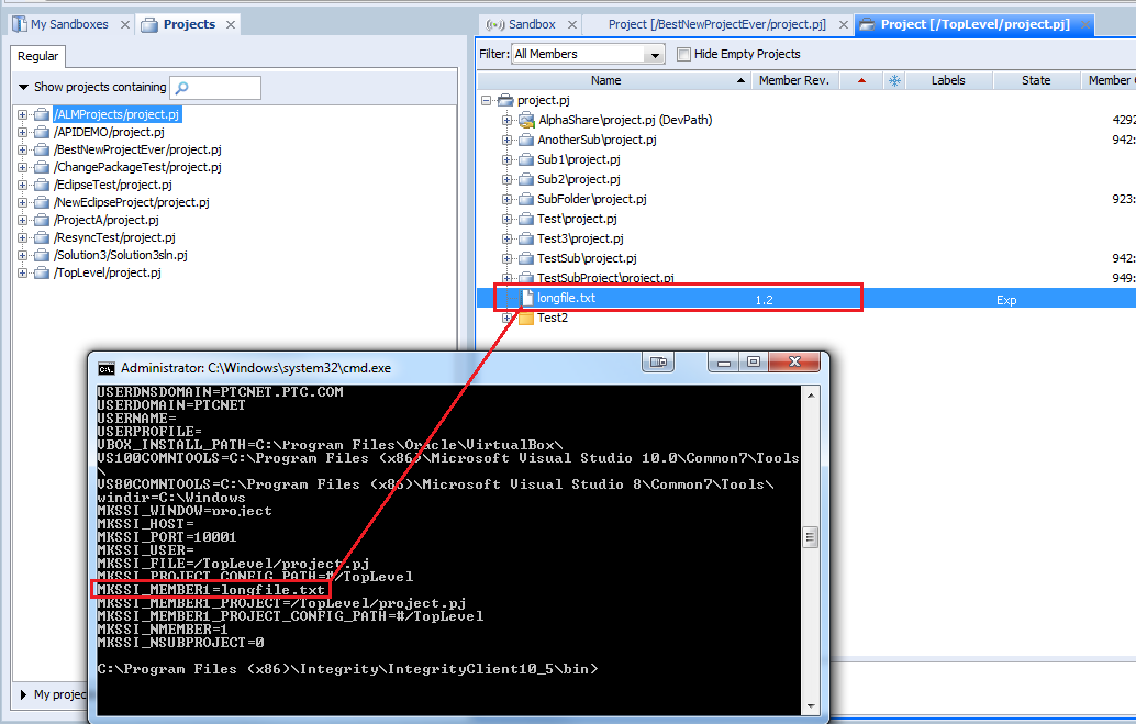

    I do not have any particular pre-formed custom commands but if you make a custom buttom to run "cmd.exe" on Windows, you will open a command prompt which shows you the environment variables the client uses. You can use these variables in custom buttons in Integrity.
    IM/Workflows and Documents variables:
    SI/Configuration Management Variables:
    Apr 17, 2014 8:12 PM UTC
    or running a bat file with
    SET MKSSI & pause
    Note the available variables depends on the current View.
