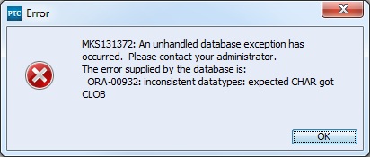

Using TestVerdictName(LastResult()) in Computation Definition causes error MKS131372
When I try to use TestVerdictName(LastResult()) in the Compuatation Definition of a custom field, I get the below error.
MKS131372: An unhandled database exception has occurred. Please contact your administrator. The error supplied by the database is: ORA-00932: inconsistent datatypes: expected CHAR got CLOB
If I just use ToText(LastResult()) then I can at least get the number value of the last result but as soon as I replace it with TestVerdictName I get this error. I think I understand what the error is saying but I don't understand why I'm getting it.
Currently I am trying to work through the embedded if statements. The field type is shorttext. The Computation Definition (which isn't complete) is:
isMeaningful() ?
IsEmpty(lastResult(), 99) == 99 ?
"ALM_Verified By Trace Count" > 0 ?
Text("Traces")
Text("Not Run")
: emptytext()

    Hello Nolin,
    This may be a product problem. Please contact PTC Integrity Support to open a ticket for this issue.
    The error is happening because your backing Oracle database is expecting a CHAR type value for a method, and is instead getting a CLOB. The ORA-00932: inconsistent datatypes error comes up anytime this sort of situation occurs, and I doubt it is as a result of your computation definition, although I am not convinced about the results of the TestVerdictName(LastResult()) call..

    Nov 26, 2014 5:16 PM UTC
    Kael,
    I will open a ticket. Thank you for the info.
