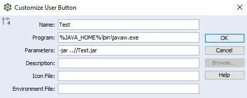

Hello community,

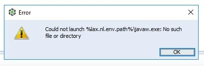

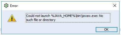

In the custom menu , i want to use the environment variable %JAVA_HOME% may also to be use lax.nl.env.path variable. Could you please tell me How to call that from the "Customize User Button" windows?
Windchill RV&S 12.3.1
Any tips well be very welcome

Hi Zeiad,
Environment variable cannot be used in "Customize User Button".
You can refer to CS175170 for the details.
Ivy

Hi @IvyZhuang
Thanks for your reply.
I was hoping that we could use .

Hi Zeiad,
I am using this script behind a custom command ("wscript runReport.vbs")
runReport.vbs:
Set WshShell = CreateObject("WScript.Shell")
cmds=WshShell.RUN("im runreport --hostname=%MKSSI_HOST% --user=%MKSSI_USER% --port=%MKSSI_PORT% --issues=%MKSSI_ISSUE0% --param=username=%MKSSI_USER% -g """&WScript.Arguments(0)&"""", 0, False)
Set WshShell = Nothing
And yes, I  am using environment variables.
Does this help somehow?
