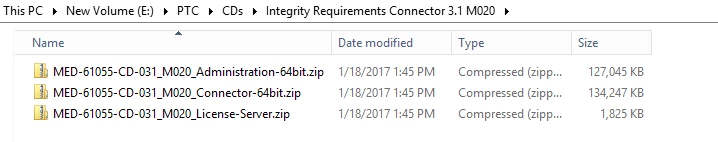

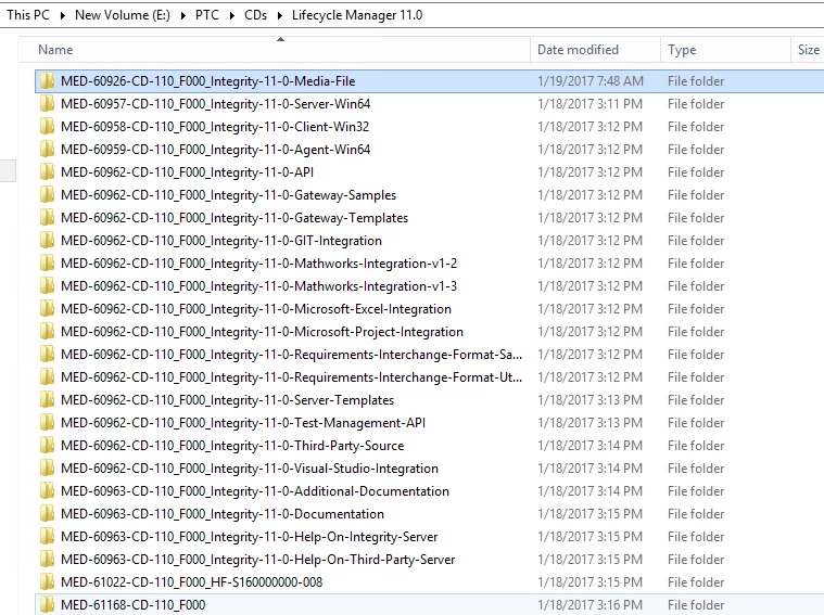

Want to install PTC Integrity Lifecycle manager, please assist.
steps to follow,
required things to setup,
which all files to execute first,
Thanks.

Hi Pradeep,
Speaking specifically for Integrity Lifecycle Manager, that's an open-ended question, but if you download the server installer, you'll fine a readme within there, that has the basic steps of running the installer for Integrity server.  For more in-depth information, about installing, configuration, and things you want to know for installation, you'll want to look for the Integrity x.y Server Administration Guide.  (x.y, meaning whichever Integrity version you're inquiring about.  ex.  11.0, 10.9, etc.)
You can find our Integrity Lifecycle Manager documentation and guides here,
https://support.ptc.com/appserver/cs/doc/refdoc.jsp?p=browse_results&Product=Integrity+Lifecycle+Manager&Release=Integri…
