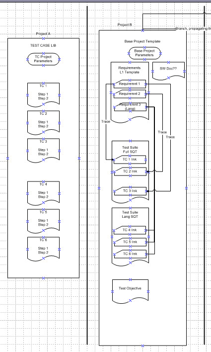

If you have two projects: Project A(this being a test case library) and Project B(this being an application), if you create test suites(with parameters) in project A and then using insert content(or include)  into a test suite in project B, can you tell integrity to assume the scope of the Project B project level parameters, instead of using the project A project level parameters?

first of all, you are right. The include/insert is a link only and will consider still the Project A as the leading for your "A" document, and will therefore take the Project A parameters.
To overwrite, the next level would be the Test Session itself. If you enter the parameters there, the two Suites will get them from there, in a consitent way.
Does this help?
