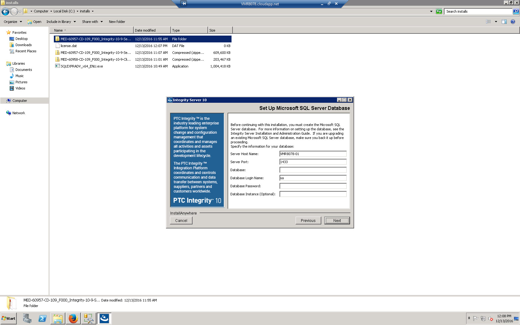

    Can you tell me which values should I provide for Microsoft SQL Server Database as shown belowIntegrityy.jpg
    While Installation Integrity Client I have provided values as
    Host Name = ptc-training.ptc.com
    port = 7001
    Dec 15, 2016 2:33 PM UTC
    Manoj,
    Are you still in the process of actually trying to install the Integrity server?  This screenshot is from that, so if so, you're not going to be able to connect using the admin client, until all of this is done?  Your SQL Server DBA should be able to provide you the values for the database (or whoever created the SQL server database being used for this).
