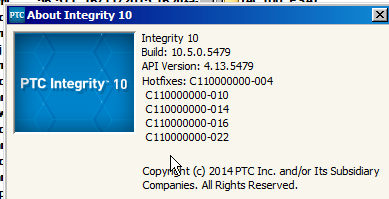

just in case, this is version we are using here
