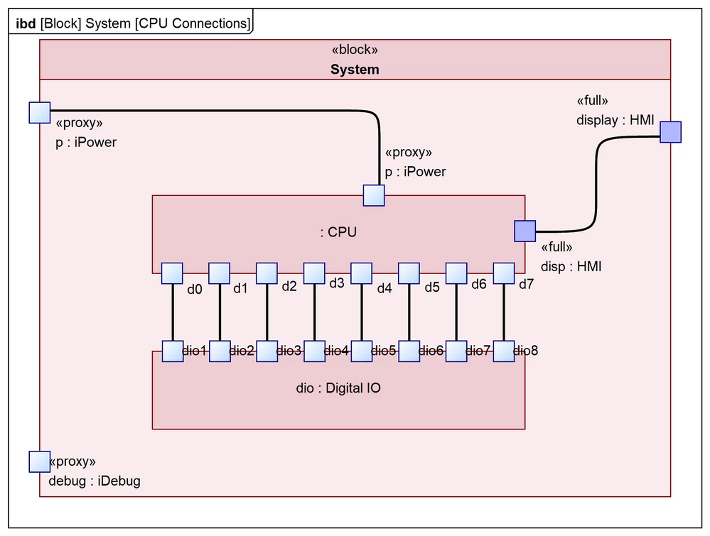

Example: A System has a CPU and a Digital IO. They are connected via pins:
![[Block] System [CPU Connections with fullPorts].png [Block] System [CPU Connections with fullPorts].png](https://uploads-us-west-2.insided.com/ptc-en/attachment/ae61334c-278f-ebe1-470a-e3a4e1d74012.png)

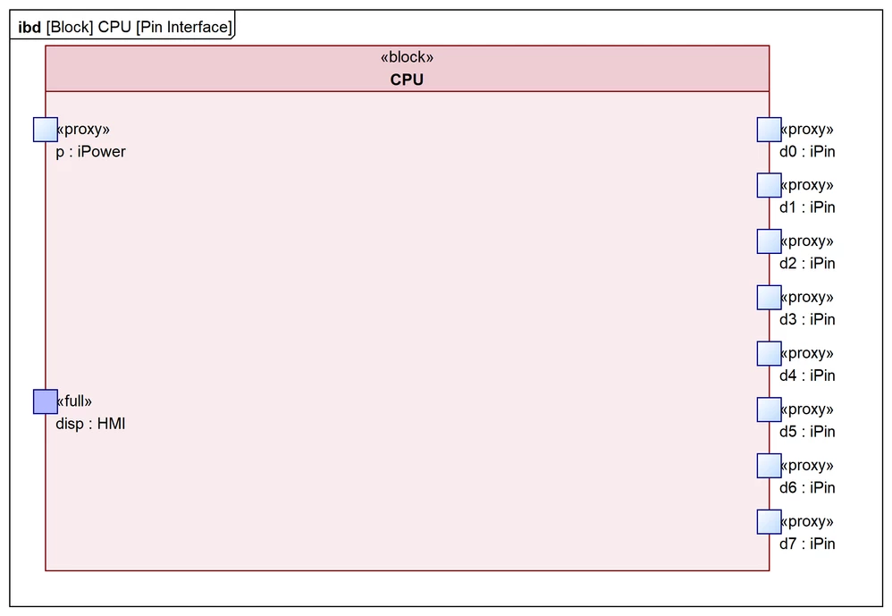

The CPU is shown with its interface in another IBD:
![[Block] CPU [Pin Interface with FullPort].png [Block] CPU [Pin Interface with FullPort].png](https://uploads-us-west-2.insided.com/ptc-en/attachment/a2ae50c3-cebd-d995-0fd5-e7793cd114b4.png)

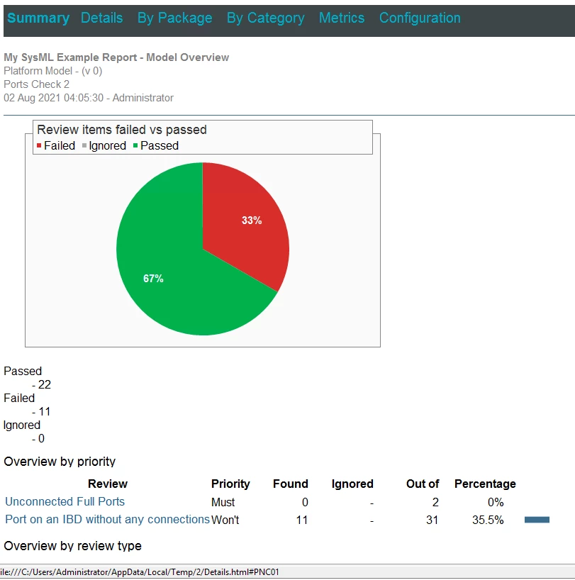

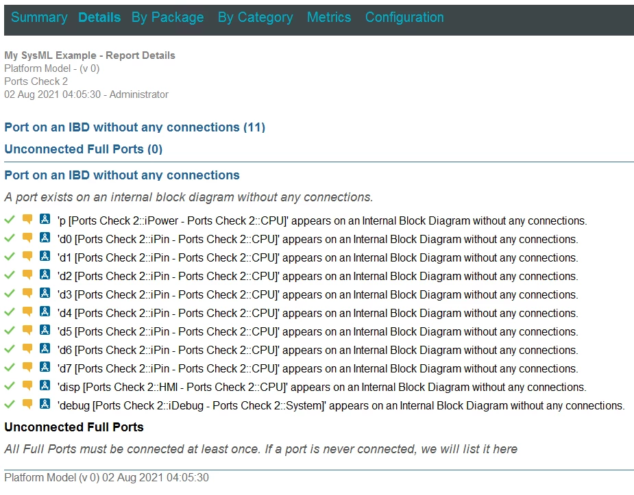

The standard review lists all the symbols, which are not connected. The new review understands that all the 2 full forts are connected, while the other review lists all port symbols, which are shown as not connected:
