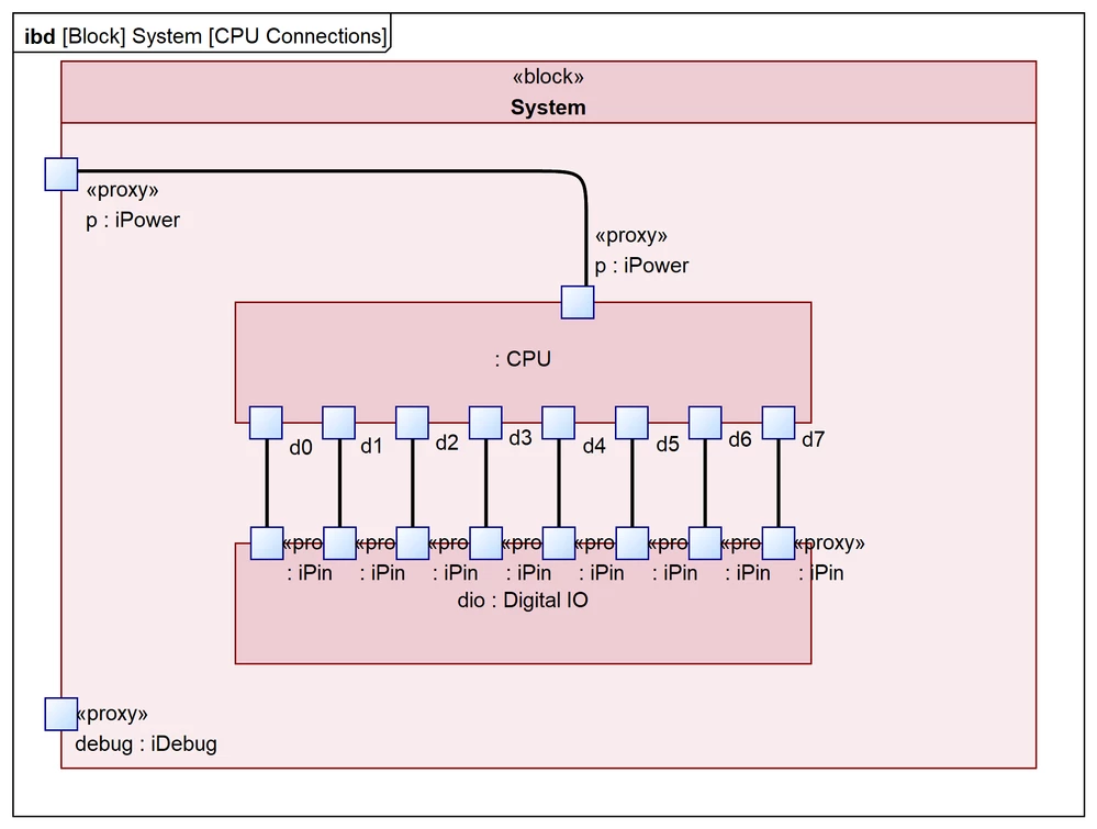

Example: A System has a CPU and a Digital IO. They are connected via pins:IBD defining connectionsIBD defining connections

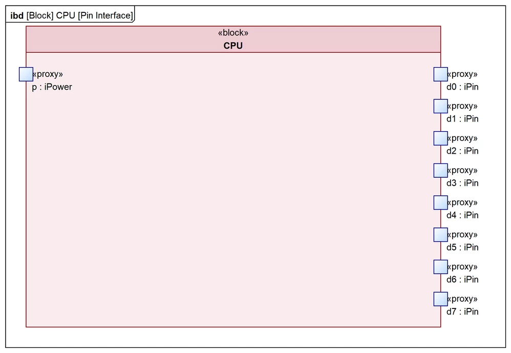

The CPU is shown with its interface in another IBD:
IBD defining the CPU interfaceIBD defining the CPU interface

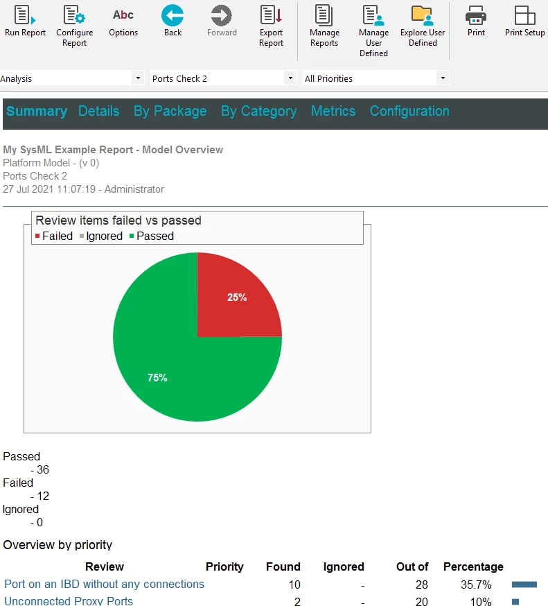

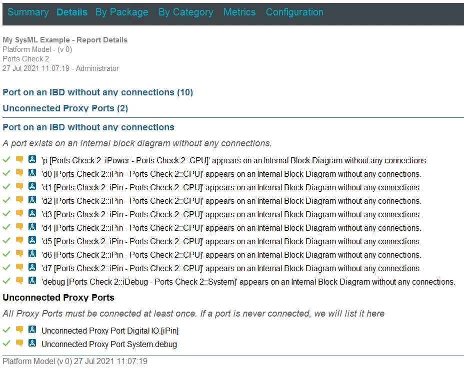

The standard review lists all the symbols, which are not connected. The new review only lists the 2 port which are really unconnected yet.Reviewer Result 1Reviewer Result 1Result 2.png
