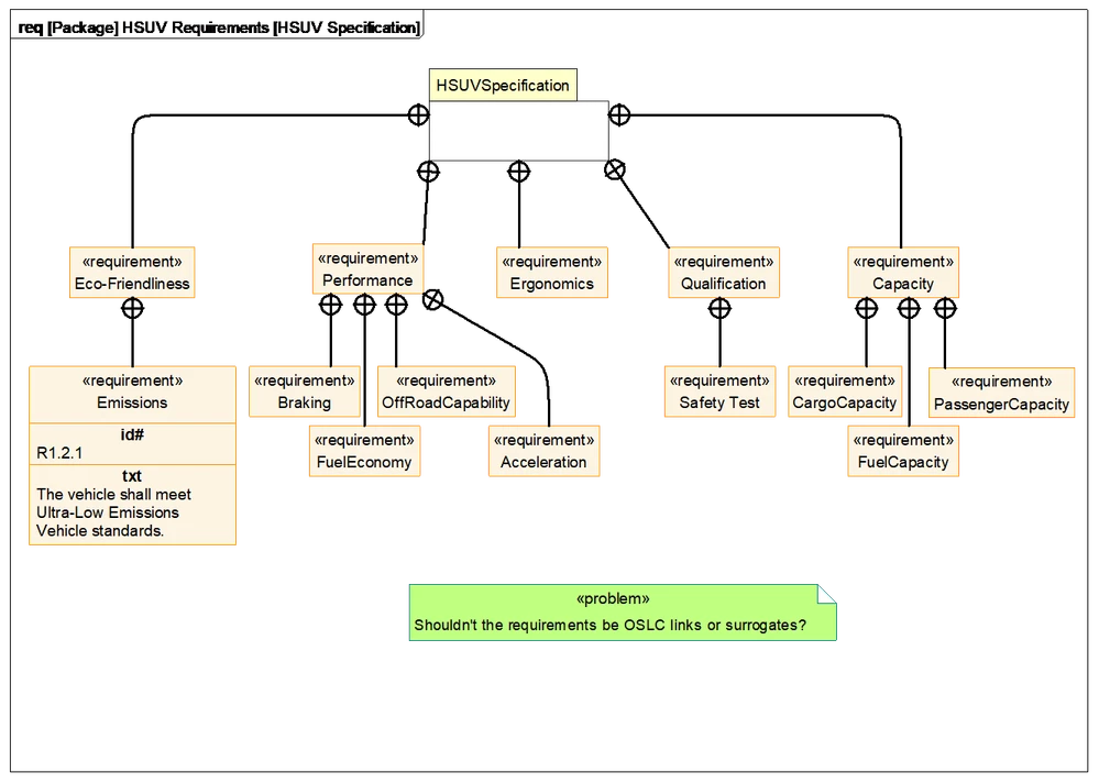

Example: In the HSUV model, I added an unconnected problem to the requirements diagram:

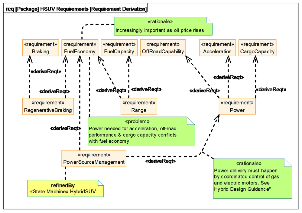

There is another linked problem already in the HSUV example model:

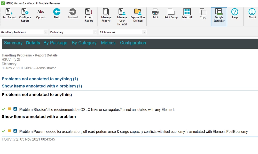

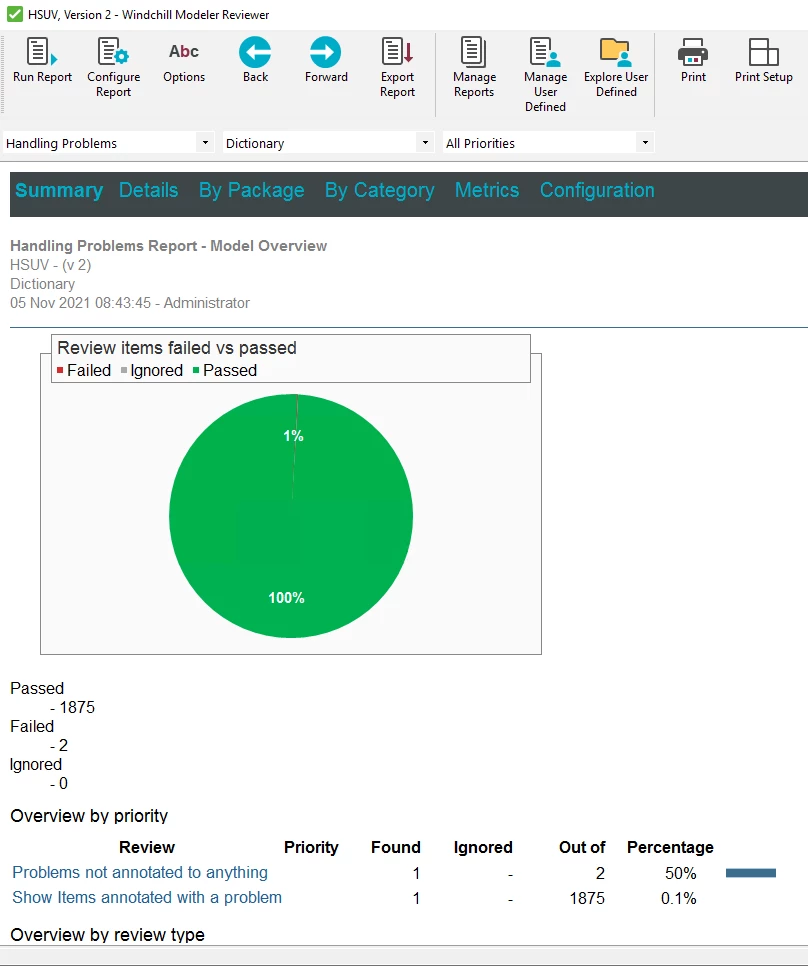

The new reviews lists both problems according their nature:
