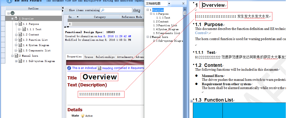

     I want to import a word document into Integrity , but when I finished import,I found that some description of a caption has been change to a child level captions.
how can i update the config to change it right?
example:
word content befor import:
     1. title one
      this is the first title.
     1.1 xxxx
     2.title two
     this is the second title.
after import:
     1. title one
      1.1 this is the first title.
      1.2 xxxx
     2.title two
      2.1this is the second title.
    Aug 8, 2016 3:08 PM UTC
    This a tricky one:
    First some basics about WORD:
    your sample (that looks like 3 headings and 2 paragraphs of text)
    1. title one
         1.1 xxxx
         2.title two
    technically contains of 5 paragraphs in WORD. You can review that when storing it as html. A Heading in WORD is the same paragraph as all others, only applied a different style.
    2. Your Integrity Import XSL seems to be working or paragraph Level. That explains the Output:
    The Gateway Import basically goes through the html Version of the WORD document from top to bottom and "converts" each paragraph based on it's style into different categories of items.
    Each item representing one paragraph, just like in WORD (only that now the inner structure is obvious).
    If you want to remain the "structure" seen in WORD, you will have to Change the entire Parser.
    e.g.
    go through the document from top to bottom and concat all text you find between 2 Headings into one Item.
    Each Item must contain 2 text fields, the potential Heading Text and the Content Text
    The result would be 3 Items in Integrity
    Section - Heading Text - Content Text
    1.          - title one           - this is the first title.
    1.1        - xxx                  - <empty>
    2.          - title two           - this is the second title.
    I would recommend to contact PTC for help with that Parser or just accept what you've already have

    Hi Matthias Rump:
         thanks for you reply, the last result you provided tha is I want , in fact ,the final working sketch is in the follow pictures.
    can you help me to config it right ?
