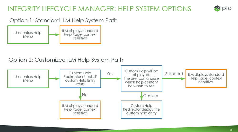

we are currently evaluating an option to include customized help into the ILM standard help system.
I am wondering if anyone of you can give me input how you today create custom help text (in your environment), and which tools you use to maintain it. From PTC point of view this customized help might come out of Integrity Process Director directly.
I am pretty sure that such a "Customized Help System Redirector", like it is briefly described below, can be implemented easily.
Here is the draft concept:

Depending on what the customer wants to see, the help should offer him both: a feature help and a process help.
A tools that could offer process help is for example the PTC Integrity Process Director.
A valid question from my side is now: what is the best approach to link PTC Integrity Process Director help into Integrity Lifecycle Manager, that a user can get the option for both?

This is an important struggle for me, so let me add a few more details:
Out of my 200+ users, I think maybe 5 maximum have looked at the help system, probably advanced users looking for some CLI details. For example, a word like "query" does not even register with them, so they don't even think of looking for help on that subject. Even a flowchart like the one above that lets the user select a topic is not enough (it doesn't help if you don't know which topic to choose).
That's because most of their questions are not tool-specific (generic help), but process-specific.
To help them in a proactive way, I need to be able to answer questions like this: "I've been assigned a Change Request with attributes X, Y and Z set at values A, B and C relevant to state S. What do I do now?"
I want my answer to be First) process-wise, you need to set X to A' and change the state to S', or assign this to someone else. Then) tool-wise, if you don't know how, this is what you do to change field X and the state or re-assign the CR.
