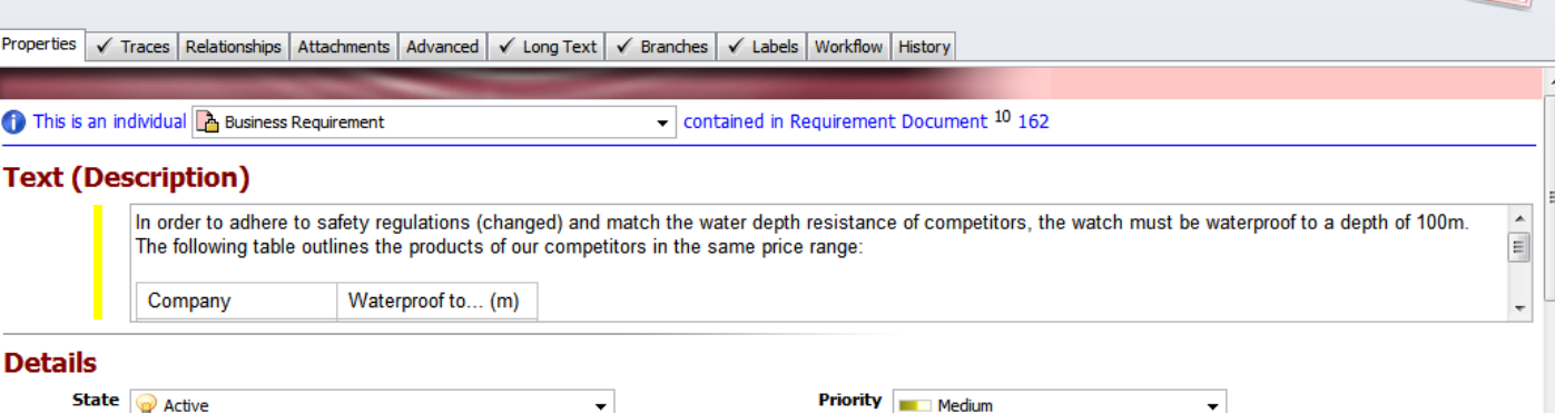

Unfortunately, there is no resizing of the text box yet.

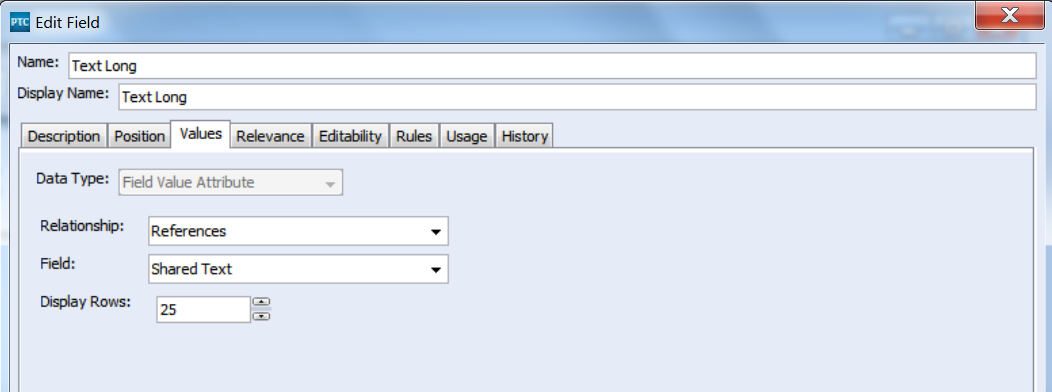

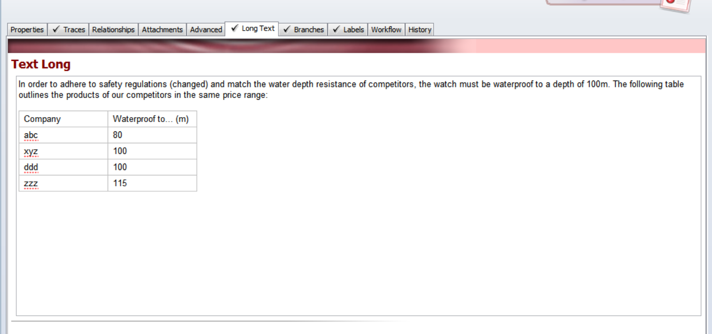

But, we can have a new field which we can put into another tab, with different sizing:
Based on the nature of the Integrity Client, both text fields will be kept in sync automatically
(in fact both are based on the same internal Shared Text).
Field Setup:
Perhaps this is something you like to try out?
Keep in mind that you should check any restriction for editability related to the standard "Text" field.
If there is one defined, you must apply this rule also to this new "Text Long" field. You should also check and update the Requirement Type properties.
