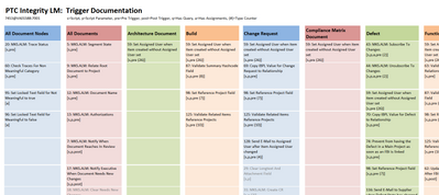

  7.  Trigger Overview
  • This report lists all Triggers with the name, and they are ordered by the type names on which the trigger fires.
  • Each box represents a trigger. Additional flags highlighting the type, the pre or post mode, if a script is linked etc.
  • image

7. Trigger Overview  (added in Nov 2017)
imageTrigger Doc (created with Java)
