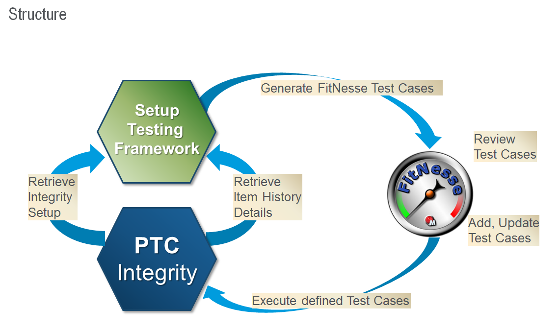

What is STeF?
Integrity STeF stands for "Integrity Setup Testing Framework" to perform functional tests by entering and updating Integrity data through the Integrity API. STeF uses the FitNesse tool (see fitnesse.org). FitNesse itself is a Wiki-based testing platform to manage the test cases and test groups. STeF combines both tools by building the bridge between them.

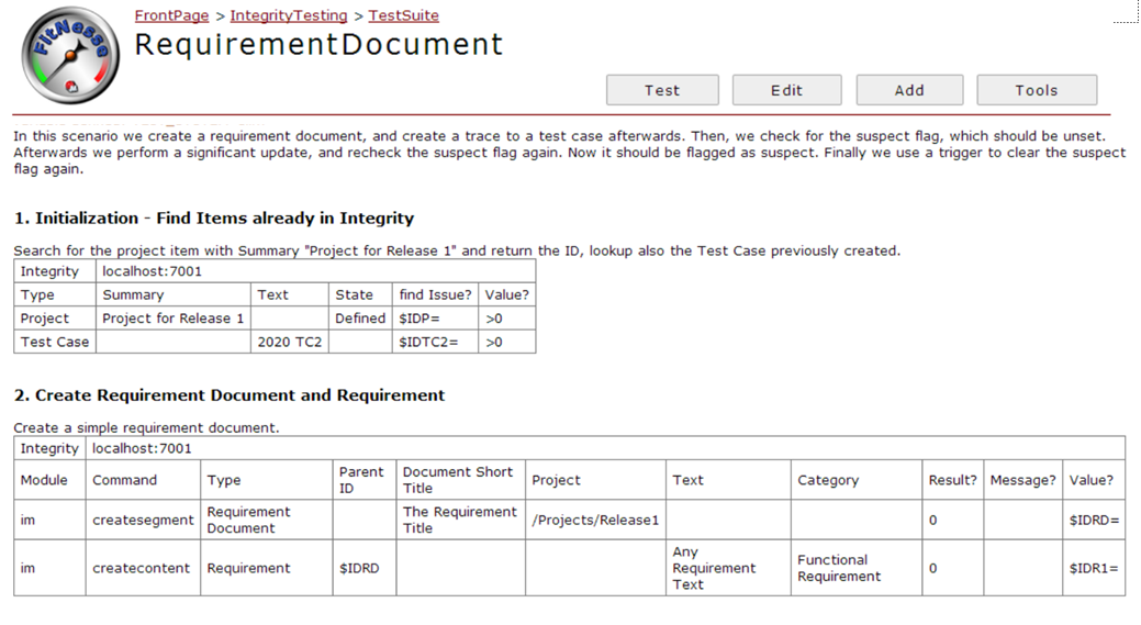

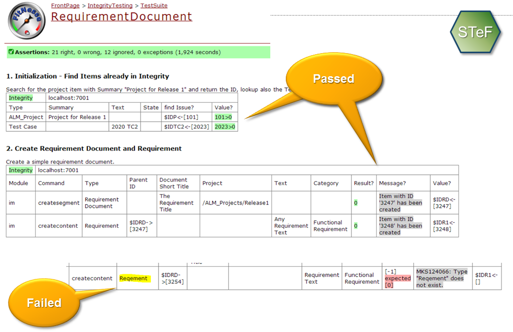

In FitNesse you use Wiki tables to define your test cases in a very easy way. Each column contains one attribute, a row is an Integrity operation, such as create item, edit item or even delete item (to cleanup your test case afterwards). Once done, you can connect via STeF directly to an Integrity environment and can execute the tests. A positive result will be indicated with a green color, a failure is indicated by red. FitNesse tracks the test history for you automatically.
Regression tests are one of the common requirements which fit nicely into the concept of FitNesse and STeF.
Note: The screenshots above showing how a Requirement Document test is defined and executed in FitNesse. Such a test can be defined for any item type.

  • STeF can also collect data from Integrity for reverse engineering of test cases.  (see second picture above)
