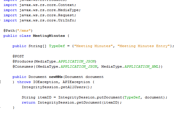

At PTC Consulting, we usually analyze different solution alternatives for our customers. During such an evaluation project, we analyzed the possibility of interacting with RESTful Services. As an outcome, a library was created that communicates with Integrity in order to obtain items and to create simple documents. (Since Integrity LM 10.9 and also in 11.1 we have included RESTeasy as one of the well-known RESTful implementations.)

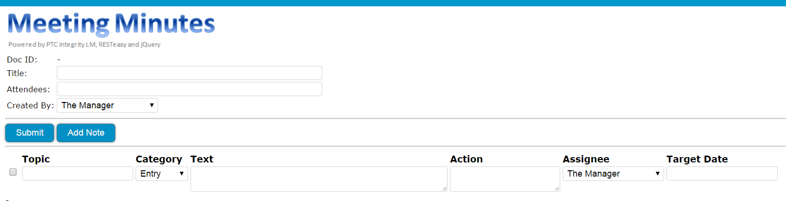

I was then looking for a good example and reminded me of my interest to go away from Excel and Word Meeting Minutes. So I implemented a simple "Meeting Minutes Application" on top of the RESTeasy libs.

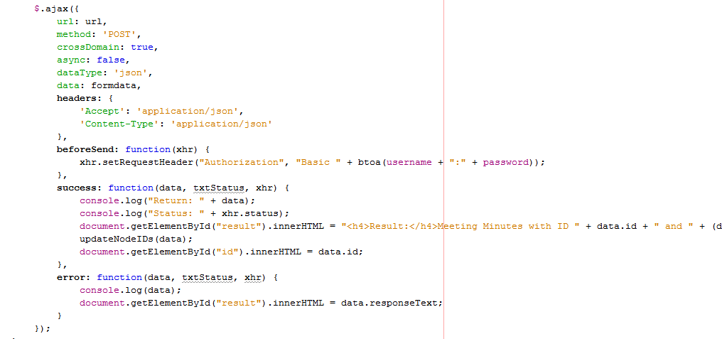

  • It uses RESTeasy, jQuery, and Java ServerPages
  • It offers REST Basic Authentication
  • It uses the server side API connection to communicate with Integrity

The Meeting Minutes form:
The JavaScript for the REST call:
The Java REST consumer:

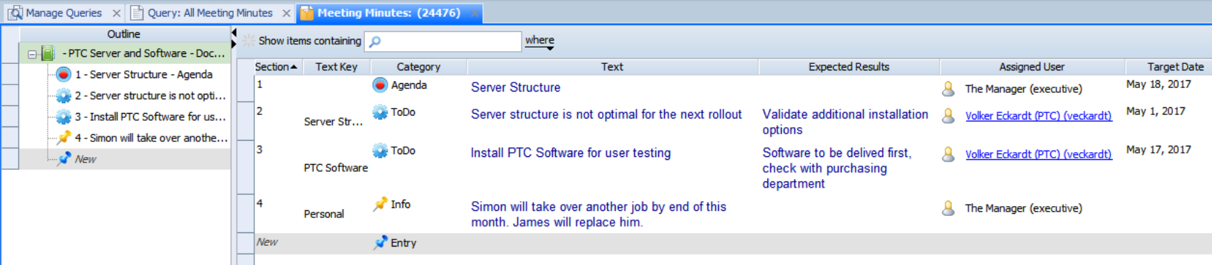

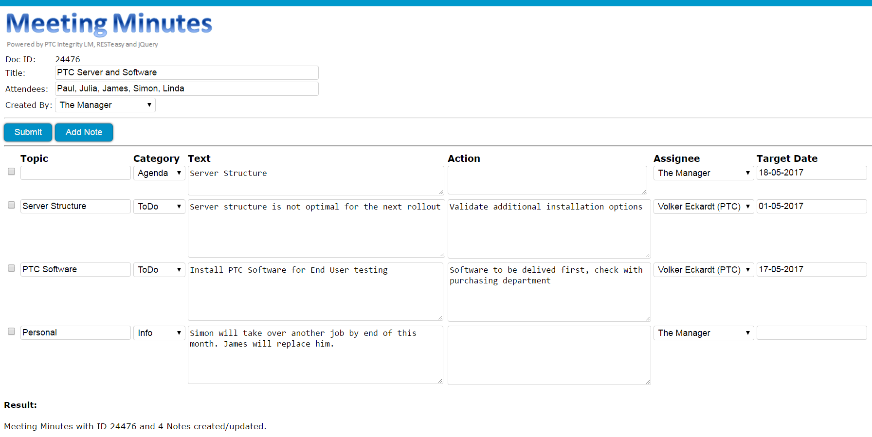

An example after submitting the Meeting Minutes into Integrity:
