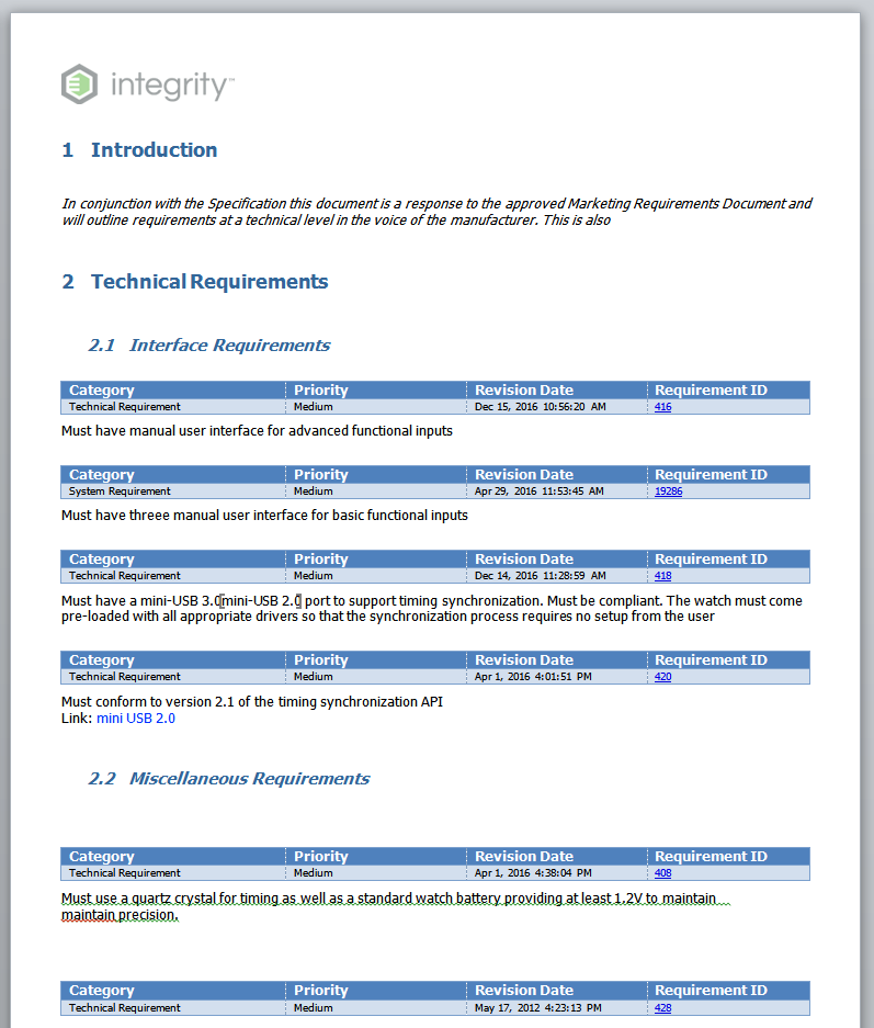

Integrity Gateway: Create standardized Output - mainly in Word Format - for any stakeholder or auditors.

The user can select one of the provided templates (export configurations) and the target file name. Then, the gateway reads and transforms the Integrity data to create MS Word output.

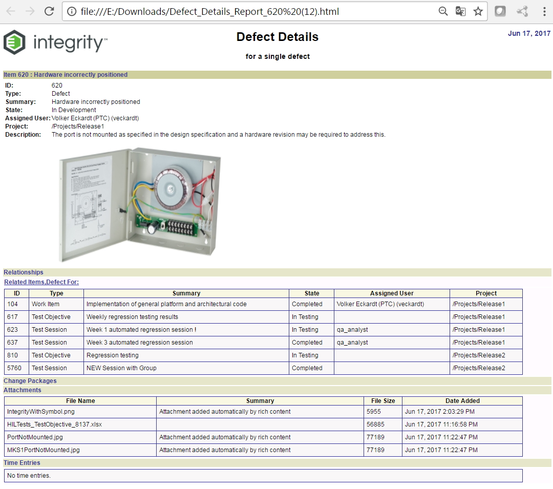

Integrity Reports are a server-based way to create HTML pages or XML files from Integrity. The layout is based on HTML templates, which are enriched with certain Integrity tags. Such tags allow, for example, to create repetitive sections based on the data provided (for data tables). Integrity reports are very powerful, although we have seen problems when complicated rich text or specific image types are involved.

Supports Output in HTML Format - - - Yes Yes
Supports Output in XML Format - - - Yes Yes

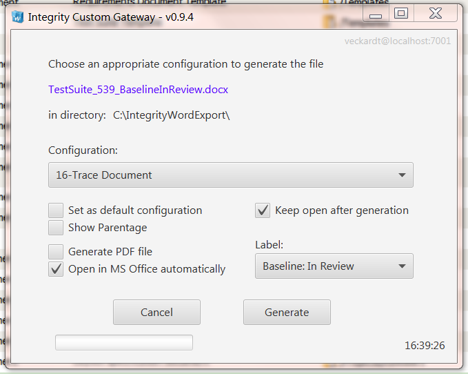

The Custom Gateway is a local Java Application which sits on top of the Gateway and offers mainly the following:
  • Flexible Output Path and configurable File Names
  • PDF Generator
  • Baseline Picker

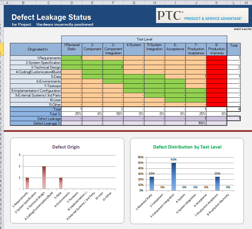

In addition, the Custom Gateway can add Java functionality to any export. Herewith you can get almost all data from any location in Integrity and enrich your data export. Examples are: trace listing, administration configuration export, audit trail listing, test document export with test session and detailed test results. All this is done with additional API calls directly before the document generation process.
The Custom Gateway also works with Excel. A similar template concept with tags as in Word was implemented. This allows you to create professional looking preconfigured Excel files directly from Integrity including Excel charts.

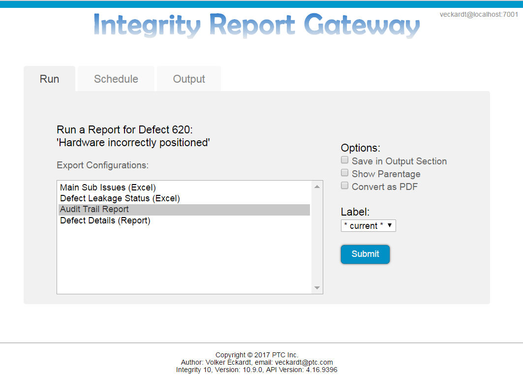

The Integrity Report Gateway is one of the latest customizations that bring the Custom Gateway functionality to the server. It was created on customer request to avoid local Java files completely. This solution already replaces the local Integrity Gateway. To further develop this solution, additional sponsors are required (current state: conceptual study, but very stable, re-use possible on request).
