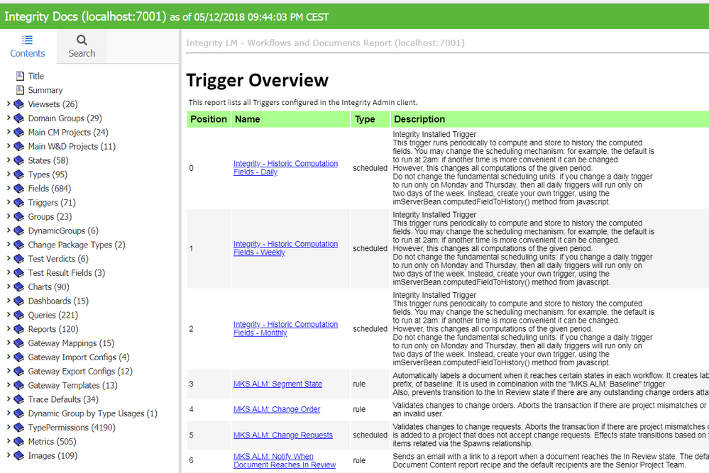

IntegrityDocs
Creates a set of HTML pages documenting the PTC Integrity Lifecycle Manager configuration.
Version
12.2: Created for Integrity 10.9/11.x/12.x and with full support of latest Firefox / Chrome / IE
Purpose
IntegrityDocs exports the current Integrity Server configuration from W&D, and creates HTML pages. Each section under Workflows&Documents will become one node within the report tree. Each section starts with an "Overview" page, and then each element can be reviewed in more detail by drilling down.
Use Cases
  • Document the current Integrity LM configuration status
  • Validate and compare the Integrity LM configuration status
  • Present the Integrity LM configuration status without the need to have direct Integrity access
