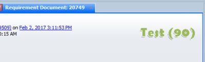

  • Environment specific images for the Presentation Layout.
Use Case
  • As a user or administrator, I want to see easily in which environment I am working.
Best Practice
  • Add an Image to the presentation layout, which has always the same name, such as environment.png
  • The link is pointing to a file on that specific server.
  • The image itself presents the Environment, such as TEST or PROD.
  • This solution also works in a stage environment.
