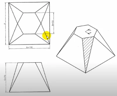

“如何使用 Blend 创建此圖像?”

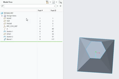

It can be made using a single blend.  Attached is a Creo 8 file.  On the Options menu, set the blended surfaces to Straight to get sharp edges. The key is getting 1 additional blend vertex on each of the 4 corners of the square and 1 additional on the left/right points of the hexagon.  And then getting the starting vertex in the correct location for both sketches so the edges of the blended shape don't cross one another.

The method I would use is to do two blends.
The first is a truncated four-sided pyramid. Defined by two rectangular sections. The base section is a square of 100mm on a side. The second section, at a height of 70mm above the base, is a rectangle with a height of 50mm and a width that corresponds to the points of the hexagon.
The second blend is a made using two hexagons. The one at the base is sized so four of its edges touch the corners of the base. The other hexagon is drawn at the 70mm height, and has the same inner size as the smaller side of the rectangle. Once this blend is defined, select remove material, then switch the "side to cut" direction to point away from the body, and you're done.

@KenFarley You are correct when using the blend feature your method works using solid geometry for both features. It does not work if a swept blend is used for the hexagonal blend geometry. No geom checks in the model but it will not create the facets as needed regardless of the remove material direction selected (see pic below).

aputman13-AquamarineAnswer
March 10, 2025
