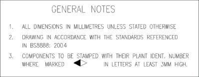

My company uses drawing templates to help maintain consistency with company drafting standards. If our standard notes need an update, I have to update all of our drawing templates (we have about 15).
Is there a way for a drawing template to pull its notes from a file?
In this way I would only need to update the notes documents?
