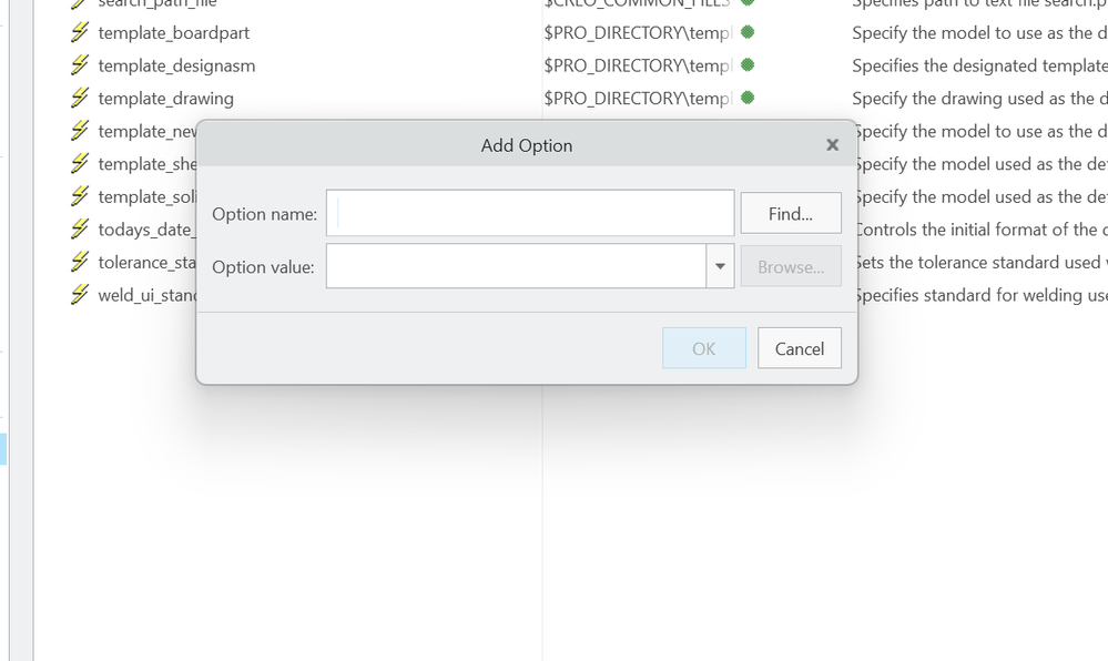

Best answer by Dario73
the problem is in the home page of the browser. You can handle this by setting the option in config.pro:
web_browser_homepage about:blank
Dario

Dario7313-AquamarineAnswer
April 26, 2023
Dario
April 26, 2023
I'm flabbergasted, this actually works. Can somebody explain the behavior? There has been a time when I did not run into problems.
April 26, 2023
This is a problem that PTC fixed with Creo Parametric 8.0.8.0 and 9.0.4.0 (I have not tested if these versions fix the problem)
https://www.ptc.com/en/support/article/CS378868
