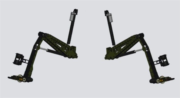

I'm using Creo 5 and can't figure out how to mirror multiple components either.  I can't believe this isn't available!?  Does no one using creo make symmetric assemblies?  Is it available in Creo 8?
Well, I'm off to make my 11 individual mirror features about the same plane.

I'm trying the same mirror command shown in the example.  But in the examples shown, they are still selecting a single sub-assembly.  I want to mirror multiple components and patterns that are not in a single sub-assembly.

While it's not the perfect solution, doing a circular "axis" pattern isn't a bad idea as a work around.  It also solves an orientation issue I was having.  It's not without it's issues though.  A couple of notes on this approach as I tried it.
  • You either need to group all the components 1st then do the pattern, or do the pattern once on the 1st component and then reference (automatic) patterns on the subsequent components.  User preference I guess.  Not a big deal either way & certainly better than unlinked components.
  • This approach does work on linear/direction patterns!  However, if you have reference patterns, the software won't let you pattern those.  Here's the steps I used to get around that:
  1. Create your feature driven reference patterns 1st.  If you do the axis pattern 1st, the refence pattern will default to this instead of the feature.  Maybe there's a way to select this, but I do not know it.
  2. Mirror the 1st part in any of the reference patterns.
  3. Create reference patterns again on the mirrored parts (not sure why this works, but it does).
  4. Now do the axis pattern on all of the other components you wish to "mirror".
 What a mess!  But I guess it still beats unlink components and having to do double work when something changes.
