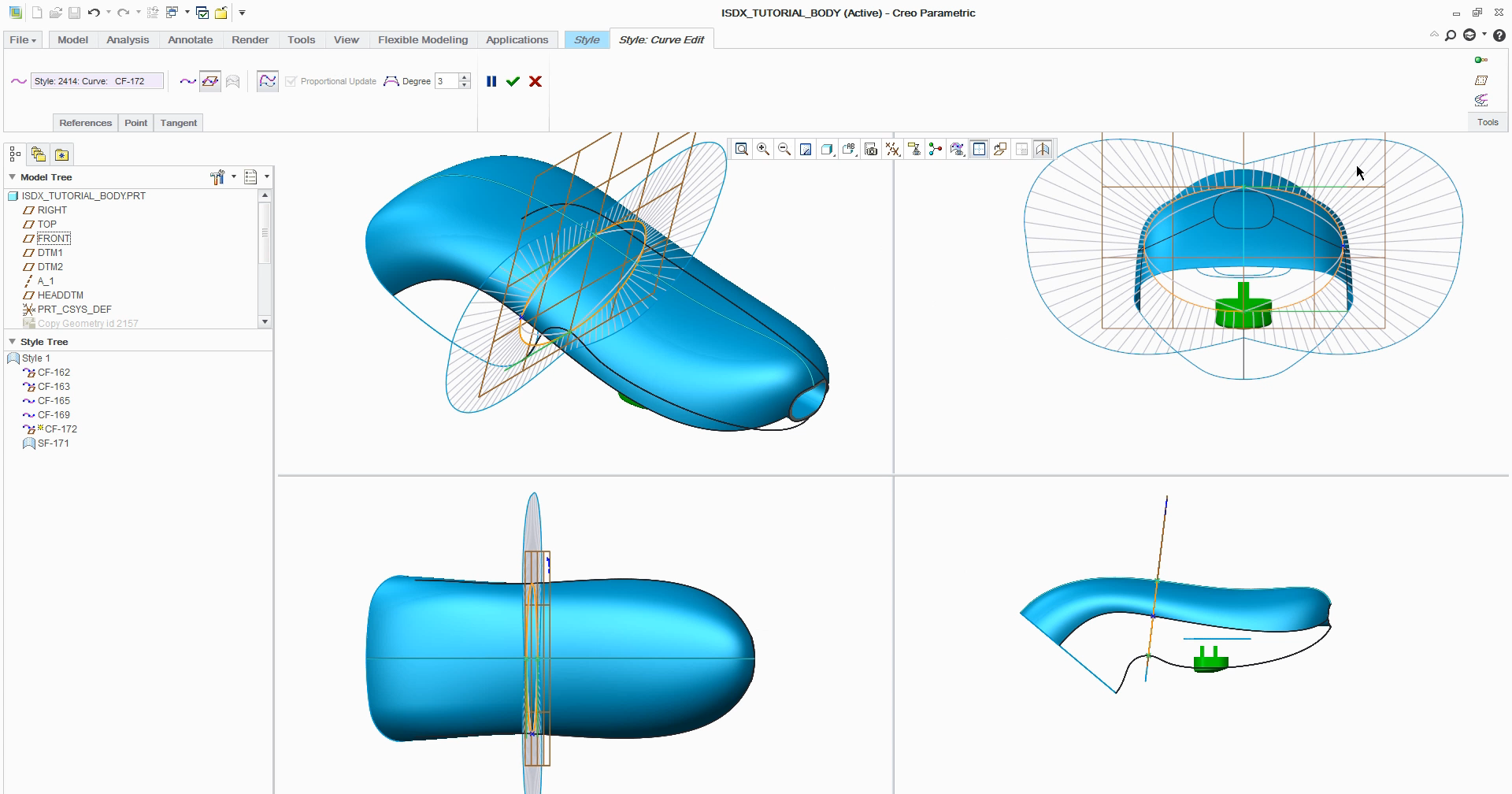

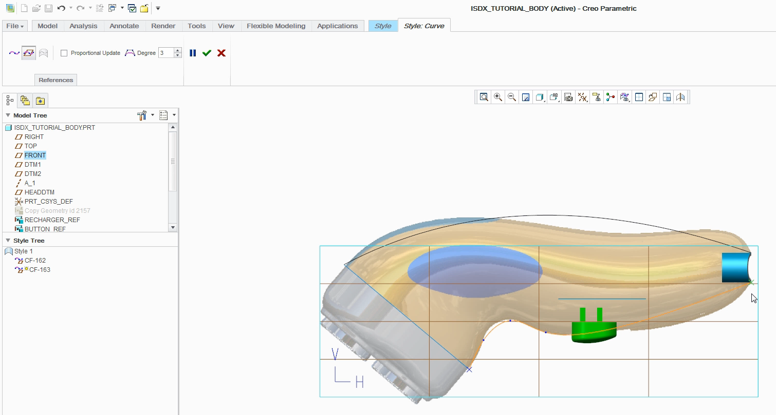

To create a curve, you simply specify two or more points.

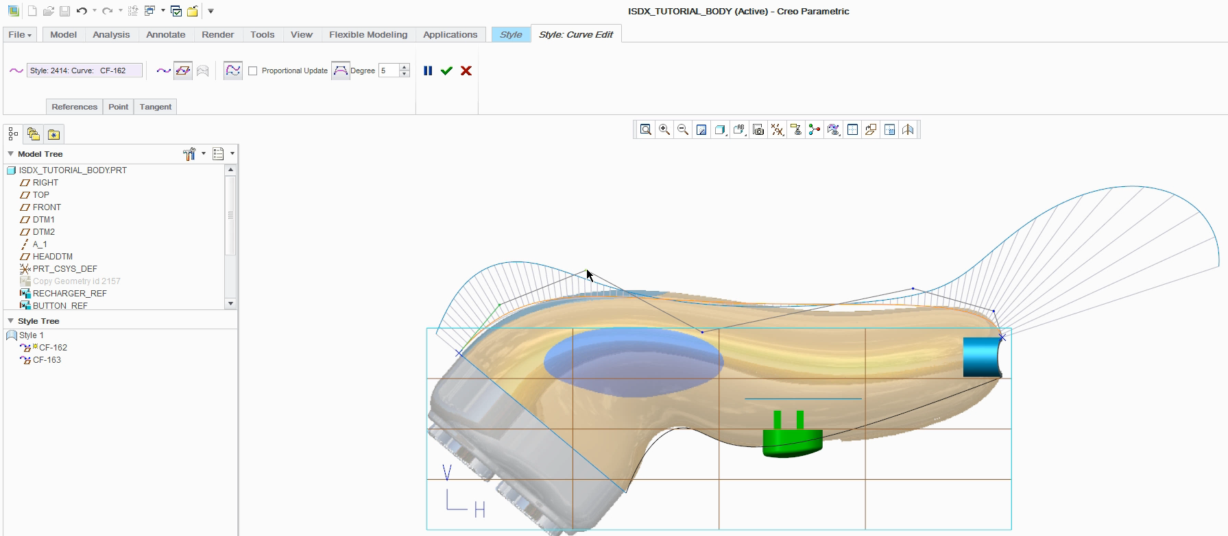

For example, in the case of curvature, dynamic and interactive feedback appears through porcupine curves, including control points. You can adjust these points so the curves meet design requirements, and add extra control points, as needed.
The Connection Analysis tool includes an option to display the porcupine curve. Porcupine curves show dynamic and interactive feedback of the curvature.
To efficiently build a curve in three dimensions, it helps to be able to work in multiple planes simultaneously. PTC Creo ISDX provides a dedicated environment with four default views to support this workflow. This helps you visualize and understand the impact of changes to a curve in all planes at the same time.

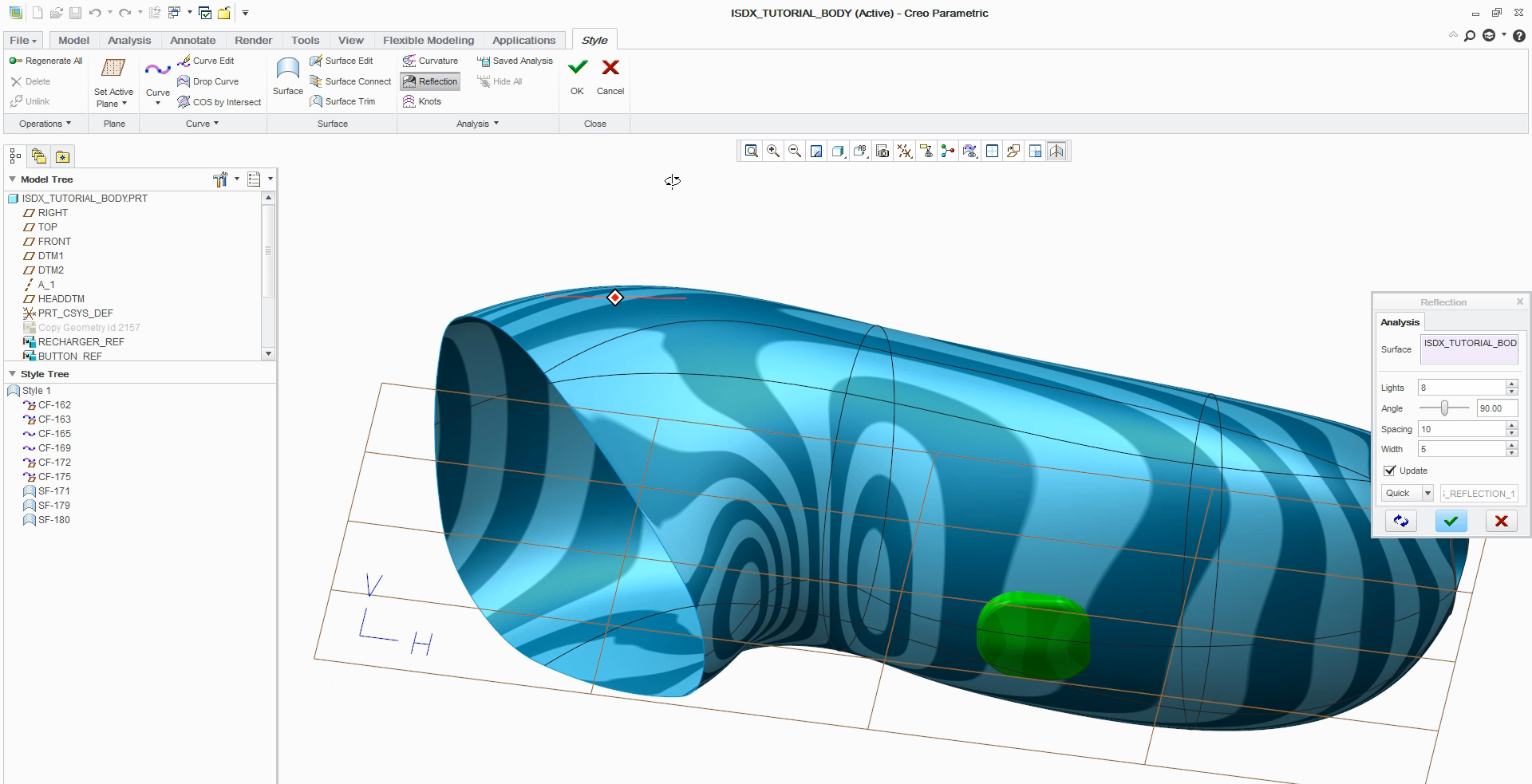

One standard analysis tool used by designers to assess surface quality is reflection plots, which simulate the reflection of light off of the surface. This helps ensure that surfaces are smooth and curvature continuous without flaws.
Reflection plots simulate the reflection of light off of the model.
