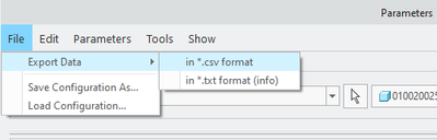

Can anyone tell me how I can Export the parameter table in .xml format? I only have the option for .csv and .txt. I know you can export to .xml because I have done it before, but now the option is not available.

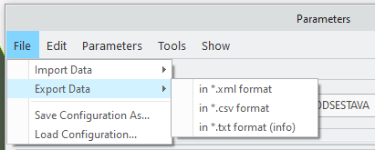

in Part and Assembly mode (Creo 5.0.5.0) I can see following dialog.
Martin Hanák
Export of parameters in XML was introduced in Creo 4 or 5. What version are you on?
Sorry, I should have listed this... I am using Creo 6.0.3.0. I was wondering if there is a config option that changed or something? I know I used to have this option.
rename your config.pro file to ensure that the problem is related to configuration option.
Martin Hanák
Thanks for suggesting that. I should have thought of that...but it didn't change anything. Even when not loading our config.pro file it still does not list the option to export as .xml.
do you have only 1 Creo installation ? If not can you see the same problem on other computers ?
Martin Hanák
I was just dealing with the same issue. The solution is kinda easy. Just use the command below "Export Data" -> "Save Configuration As". By default it saves an xml file.
EDIT:Aww, dayum, it doesnt save the params and values. **bleep**.
CREO 7.0.2.0 has the same options as you have.
