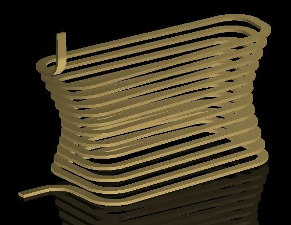

For fun and practice: Rectangular helical spring
So, the last time I played with this (quite a while ago, right before my spineless/nutless stalker trolled people here), there was a little distortion in the corners where the spring got smaller.  This iteration is more complex, with a lot more features, but then I'm trying to get a lot more complex shape and I managed to eliminate most of that distortion.  You can't get all of it out because, honestly, Creo isn't meant for or 100% capable of what I'm trying to get it to do.  No matter, I got as close to perfect as I think is possible and reasonable.
Of note:  Creo flat refused to let me use a boundary blend to wrap a curve onto, at least in my application.  Also problematic were trying to use C2 continuous rounds to wrap onto, Creo seemed to like a conic round much better and the result is basically the same.  There is no "wave" to this helix as you would get in trying to use a helical spiral around an axis, as you can see by the fact that the flats are parallel to one another.
And so, have a look at the STEP file to see what's possible, and think about how it MIGHT have been done...and give it a try...

This was WAY faster and easier, but more "artistic"....and there might even be a use for it....hmmmm...2021-06-30_SPHERE_SPIRAL-01.jpg

These were done using what us Olde Timers call VSS's (Variable Section Sweeps), which of course use a "spine", something my stalker here certainly lacks...😂🤣

I think more people would be interested in having access to the native Creo model vs. trying to recreate this on their own from scratch.  I certainly wouldn't mind exploring how the different features were created to build the final result.  No matter how long someone might 'play' at building something like this, without the years of experience you have they may never be able to achieve the same finished product.  Maybe you could record a video showing how you created the model.  This would keep you from having to share the actual file while at the same time help people understand the nuances to creating something like this.
Patriot_1776
Jul 13, 2021 3:52 PM UTC
'Sup Tom!  I can e-mail the model to you if you like, just let me know.  I think I still have your e-mail.  I guess I'm interested in seeing if people might have an interest in trying stuff like this, and then directly corresponding with them instead of just putting models out there for everyone.  Too many people are just lazy and want people to do their work for them so they don't have to be bothered working for anything.  I want them to work for it a little at least.  If someone posted an interesting STEP files I'd certainly want to re-create it on my own.  "Spoon feeding in the long run teaches us nothing but the shape of the spoon."  🙂
