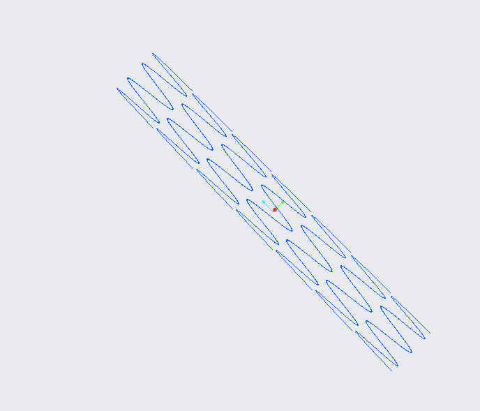

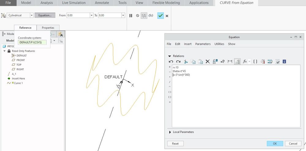

Hi Folks, im trying to draw a model for a sinusoidal stent on creo to later be used in ANSYS as a part of my final year project in college,(Stent FEA) ive started by drawing the sine wave using an equation in creo, then mirrored this pattern to create a flat wall, im looking now to make the pattern into a cylinder shape before selecting my geometry for the analysis. but im having serious trouble getting the stent to wrap, ive tried a toridal bend but no joy! any one have any ideas or can help? ive attached some files below.

Mar 2, 2020 7:33 PM UTC
Hey thanks for your response, something along those lines!
kdirth
Mar 2, 2020 8:21 PM UTC
Are you looking for something like this?

@moseybyrne
I think toroidal bend will help but in this case it might be failing due to multiple mirrors, try creating waves using curves instead of mirror. I hope that should help.
Mar 2, 2020 6:50 PM UTC
I thought so too, but I tried the toroidal bend with just the original part with no mirrors and still didn't work! Thanks tho!

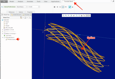

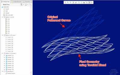

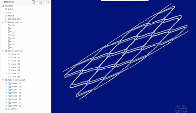

BHOoi
Mar 3, 2020 8:02 AM UTC
I created the attached model using sweep in Creo2. Is this similar to what you wanted to model?
