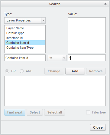

I would like to perform the following search: Type: Layer Properties (Contains Item id) != * (image 1), but I get this error: "Invalid value for Contains Item Id".
If I try this search: Type Layer Properties (Contains Item Type) != * then I get no error, but also no results.
Bonus points for a way to search only empty drawing layers (Type: Layer Owner (Layer Model) = *.drw).
Any ideas?

I do not know if it is possible to find empty layers using Search tool.
What you can do ...
  • show Layer tree
  • select root of layer tree, this means Layers node, press RMB and run Layer Info command ... it creates file layer_partname.inf file
  • in inf-file you can recognize empty layer ... its section does not contain LAYER CONTAINS: string
  • you can create script which executes empty layer recognition for you

I was not able to select all empty layers, but I can select all layers containing an item:
Contains Item ID > 0
then I can select all those layers and copy them:
~ Command `ProCmdEditCopyLayer`;
then I can delete all layers, paste the copied layers and then re-apply the rules (from a default layer model) for the pasted layers.
