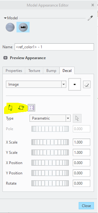

Sorry, its been a while and I gave you bad advice. Here is the correct information:
1. Click on appearances, and edit the appearance that contains the decal.
2. Click on the eye dropper
3. Select the surface that the appearance is applied to. After that, the dialog below will show up and then you can flip the decal as required:
